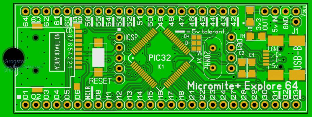

OK then, I will route Vbus somehow. This does allow for the MM+ to perhaps host a USB keyboard on it's USB socket, if that was ever added.
The only problem I now see, is that someone could solder-blob those pads AND install a daughter-board. That would be bad, so perhaps I should remove those solder-blob pads?

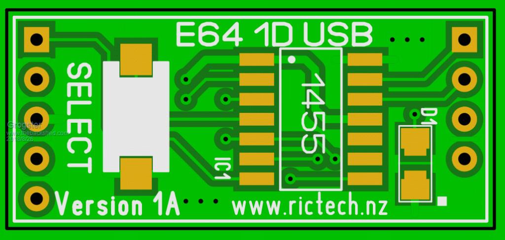

How about my comment on having the solder-blobs in place, and then you install the daughter-board - this will then connect the PIC32 USB directly to the 1455 USB, which would not be a good thing.
Apart from the fact that the USB bus would probably get really confused, is there any ELECTRICAL risk if that happened? IE: Would doing that damage one or the other chip, or will it just prevent any USB working on that port till you isolate one or the other?
Posted: 07:59am 21 Aug 2018
@Peter,
I fully appreciate about a parallel USB connection but what are your thoughts with the following:
D+ and D- from the E64 USB socket being wired to the MM PIC (but MM Vusb not connected) AND D+ and D- from same E64 USB socket also goes to 'MicroBridge' PIC
Will the MicroBridge/PC communicate correctly, or will the MM PIC (D+/D-) somehow 'interfere' with the MicroBridge comms?

if you are fitting a 1455, why not keep two seperate USB sockets, with the daughterboard carrying the second socket? they could end up sitting one vertically above the other.
remember, there is the USB OTG pin of the onboard USB socket routed to a pin on the PIC32. it may be possible to use this as a means of either (a) detecting if the daughterboard is attached, or, (b) overriding OPTION CONSOLE OFF
i could be way off the mark here, having never seen or used an E-64, and not having looked at the schematic. i just remember asking that the OTG pin be routed to what i recall was an input-only pin on the PIC32, and folks agreeing that it was a good idea.

Posted: 08:57am 21 Aug 2018
My understanding was that Vbus disabled the D+ and D- lines at both a hardware and a software level (when not connected to +v).
When a voltage is detected then it enables USB D+ / D- on the PIC.
I will investigate / experiment later today as now have to go out . . . .

In the 1B's and 1C's, if you plug in the USB cable, Pin-34 is connected to the 5v USB voltage. I have run E64's with the plug in, and the motherboards that use the E64 module as the 'CPU' do NOT have the USB cable connected - they are powered directly from the 5v pin on the module, with J1 removed(USB 5v NOT routed through to regulator)
On all E64's, Pin-35 of the QFP(Vusb3v3) is ALWAYS connected to Vdd(3v3). It is ONLY pin-34 of the QFP(Vbus) that is connected or disconnected via the USB cable and socket.
This has not changed, and won't. It is only Vbus(pin-34 of the PIC32) that we need to worry about.

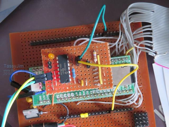

Posted: 03:31am 26 Aug 2018
I made a "veroboard special" microbridge.
I did add a 0.1uF capacitor to the power rails (out of habit).
I also have terminals so I can re-flash the pic if needed.
It works on my explore64 but I have to re-visit the USB side. I have a fault in the butchered wiring so I am using a separate USB cable direct to the microbridge.
Posts: 10081
Posted: 04:26am 26 Aug 2018
Clever! The USB D+ and D- must have been tricky to get at....
The new 1D's have been ordered. This is the 1A prototype run, so I have only got ten of each, just so I can check that everything still works as expected. If that is OK, then I will get panels of three made for the new design, and I will also put up the new design and optional USB board on the website.
The new boards are blue. Weather I move back to green for the production boards remains to be decided, but I was getting sick of all my boards being green, and PCB GoGo don't charge any extra for a different colour soldermask. It used to cost quite a bit more to get any other colour then green, but like everything, that has changed now.

Great that you managed to squeeze in the VBus pad as well. Solves any potential USB issues. Even if it works now that could change in a future version if MM USB code is changed.
