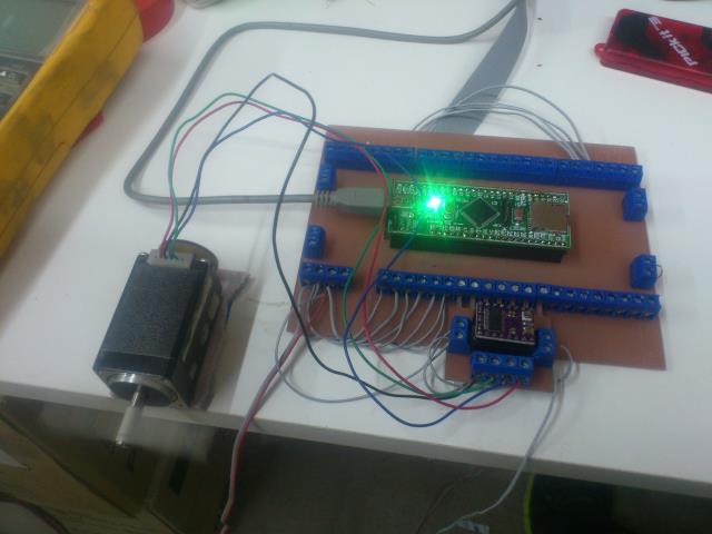

Just for interest, I pushed things a little harder and managed to get a no-load speed of 3860RPM out of the motor. (Mostly regular with only around 10% of cycles missing steps causing a stall)
That's a PWM frequency of 205Khz and 50% duty
I only realised I wouldn't get much more when I hooked up the DSO and saw a pulse width of 2.2uS - the driver board needs 1.9uS minimum so it's really running on the limit!
I'm impressed

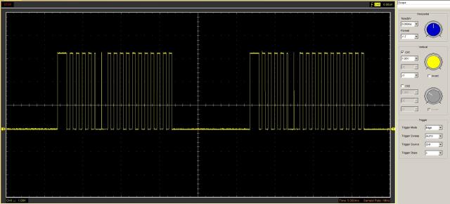

(Edit: Ooops, I hit the post button too soon)
It only comes in to play and is noticable AT the 1249 to 1251 range. That's also an unlikely scenario to ramp up from 1249 to 1251 as minimum speed set to maximum speed set. Speeds will pass through that range, but only on the way to a faster speed.
If you're happy to fix it Geoff, I'm happy to test it - but for my purposes it does what it should
Edited by Malibu 2018-08-08

Here's the waveform with BaseHz set to 1249
Azure
Joined: 09/11/2017
Posts: 446
Posted: 11:32pm 06 Aug 2018
I am not sure what that first long pulse is from, it should be the same as the ones after it.
At 1249Hz the pulses are about 0.8ms, so there are about 5 pulses before it changes to 1250Hz which is right where the second glitch is. Then 1250 to 1251 looks smooth (5 more pulses each with a clean tranistion.

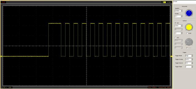

  Quote  I am not sure what that first long pulse is from, it should be the same as the ones after it.
Agreed... I presume it's how the register is first loaded and the way the PWM is initialised.
Run this code,
BaseHz=1000'1249
for j = 1 to 500
for i = BaseHz to 1300'(BaseHz+20)
pwm 1, i, 50
pause 5
next i
pwm 1, stop
pause 10
next j
pwm 1, stop
pause 1000
... and you get this...
When it periodically shows up, it's always a wide pulse on the first cycle (similarly at the other end, there's often a narrow pulse on the last one - presumably that's depending on when the PWM is turned off).
The set frequency is perfect from the falling edge of the wide pulse to the next falling edge.
Not a big deal for my situation, but could be an issue trying to control servos when they need a precise mark/space.

For your interest, so far this stepper has been running a continual [ramp up-ramp down] cycle since around 9:00am and hasn't skipped a beat.
