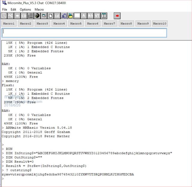

Attached 5.04.18
2018-06-26_012447_Armmite.zip
This fixes the issue with loadable fonts/Cfunctions (what a pig that was to diagnose!!!) and the time loss during NEW commands. Also, you can now reset memory and options by holding down the USER button on the Nucleo while pressing the RESET button - same as using "!!!!!!" on the MM and MM+.
I've also been able to prove CFunctions work using an old one from the very original F4 Armmite. This was compiled on Coocox COIDE for the STM32F4 but works perfectly on the H7
CFUNCTION strrev
00000000
b085b480 6078af00 687b6039 60bb781b b2da68bb 701a683b 60fb2301 683ae00d
441368fb 68fa68b9 32011a8a 440a6879 701a7812 330168fb 68bb60fb 68fb1c5a
d8ec429a 461a68bb 0300f04f 46194610 46bd3714 7b04f85d bf004770
END CFUNCTION
Edited by matherp 2018-06-27
