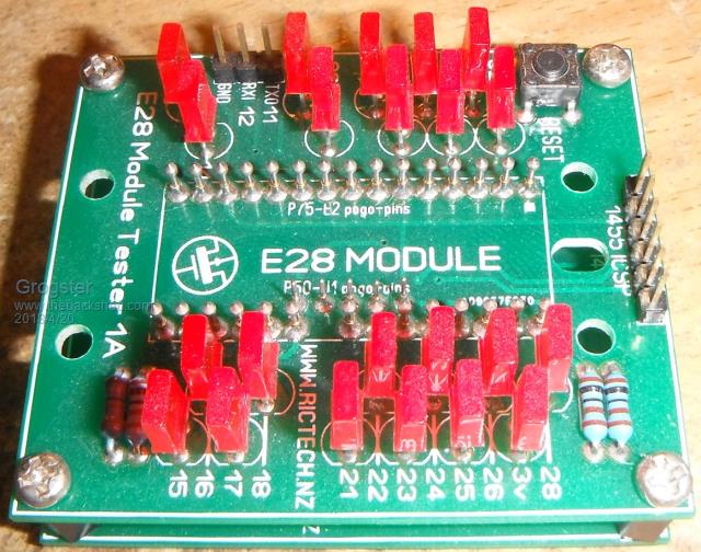

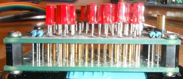

Assuming you mean the Pogo pins, I use TWO of the same board, stacked with short spacers between them, and a small offcut of PCB taped to the bottom of the bottom PCB covering the pogo-pin holes. This prevents the pins dropping right through both boards, and also ensures that all pins are at the same height.
Then you push the pogo pin through BOTH boards from the top(which are now stacked), and solder the pogo pin to the top of the via on the top board. Both stacked boards keep the alignment almost perfect at 90' to the horizontal of the PCB.
That done, remove the top PCB, and solder the bottom side of the vias on the top board you just removed. I find that it is best to then replace the top board in the bottom one, as that protects the pogo pins from damage.
Like this:
The PCB does benefit from having close-fitting vias for the pogo pins, as that also helps keep them square to the PCB. I usually make the hole in the via 0.1mm wider then the pogo-pin, that way, they are a snug fit.

What a great idea.
Paul.
