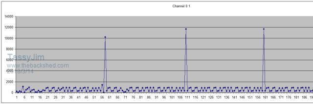

PeterM wrote a Cfunction for transmitting bitbanger data and disco4now used it to write an Arlec mains switch transmitter. The Arlec bit pattern looks very much like your data.
If I can read your data, I can use the Arlec code to produce a simulator for your transmitters (complete with white noise preamble). That will make writing receiver code easier.
Posts: 10076
Posted: 06:04am 14 Mar 2018
OK, Standby.....
Posts: 10076
Posted: 06:07am 14 Mar 2018
OK, here you go:
LINK TO CSV FILE
This is with the DEFAULT SETTINGS in Logic 1.2.10
Channel 0 only, as that was the only one I had connected.
Posted: 06:36am 14 Mar 2018
That looks better.
I can read the file OK and found where the data started.
It starts at sample no ~5600 and runs for ~1000 samples.
You can easily see the short, long and sync timing in the excel chart
There are a few 'errors' in the first pulse train so that is good to have for testing.
I have domestic duties for a while but should be able to get a simulator going in a few days.
