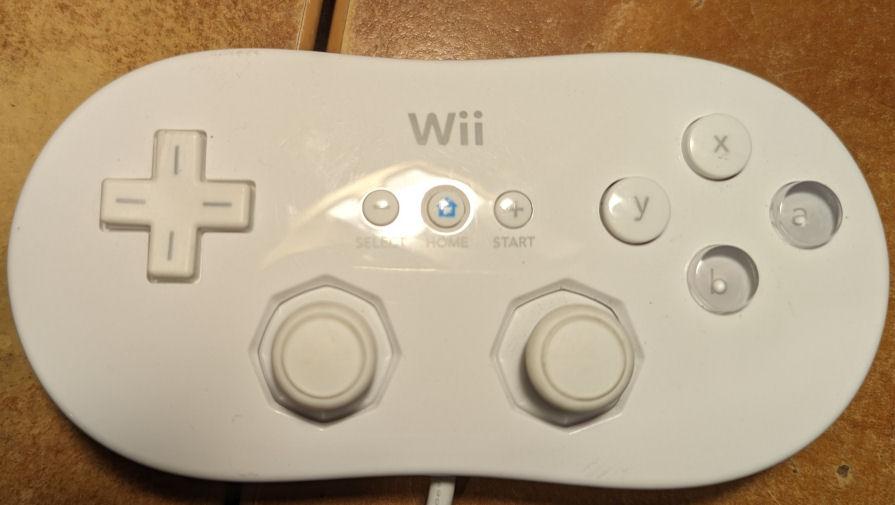

I've got a Wii classic wired to a GameMite and will post  I/F code sometime over the next week or so (traveling for the next three)

Posted: 07:51pm 15 Nov 2023
I like the idea of having the WII controllers on the PicoMite (or any I2C controllers for that matter). I just don't like using the PCB as a connector. Looks like I could get sockets from AE though.
I had reasonable success in using a RP2040-Zero as a I2C slave controller for both analogue and digital inputs. I never got round to testing it on a decent length of wire though.

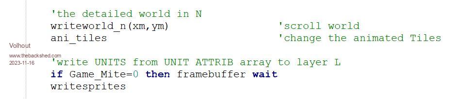

Hi Kevin,
Thank you for your explanation. I was afraid this would be your reasoning, and hence my worries. Let me explain.
In the game loop there are functions and subs that work on background data, and subs that actually write to the screen. Sometimes the name of the subs can be confusing (due to my personal development in writing games, I sometimes changed the content (and thus function) of a sub. And it not always exactly does what it's name says (i.e. writeplayer does not actually write to ecreen anymore).
In the game main loop, all screen (either VGA or LCD) activity (block screen write routines) takes place here:
writeworld_n: copies section of the world map to N layer in the view window.
writesprites: clears L layer and redraws all sprites.
subs like "ani-tiles" and "writeplayer" prepare data for the actual screen writing routines, but do not actually write.
The only exemption to the above is the data that is written in the game border on layer N. The weapon/item/key/player face/comments are directly written to N, only when changed. And the loop time indicator in the top right, is written each loop.
Now about your change.
Since you have not changed the order in which writeworld and writesprites work, you have not fixed what you intended to fix.
But you did change the timing relation in the loop between the block screen write routines, and the "incidental" screen write routines that show weapon/item/player_face/comment strings and loop time.
P.S. I was able to lower the loop time by 10ms by re-organizing the "scan_units" SUB.
Hooray... now we can add the missing things.

Hi Harm,
Ok I can see what you mean, in that case, I know what is happening, the LCD background update is started, at the end of the main loop, so by moving the writeworld_n and ani_tiles to after all the player and robot logic, it is allowing enough time for the LCD copy to finish in the background, before the next writeworld_n and ani_tiles are called, which in theory is even better, as long as no other problems.
Anyway, whatever the reason, I can't now see any problems with the LCD display. Before the code was moved, if the player ran along the side of, or towards or away from water, for example, you could see, the water offset, tear or only partially drawn, briefly, which to me didn't really matter, now, assuming you can't see any problems with the moved code we may as well leave it, because it seems to fix any screen tearing. :-)
I have tested Peters latest B19, with built in Framebuffer Wait, with both the original, pet24e, which is still tearing, I tried using both the full Framebuffer merge, and also Blit merge, there may be a slight improvement, it's difficult to judge, with the revised pet24emod, I can't detect any screen problems.
Regards, Kevin.
PS 10mS is very impressive, I thought it would turn out to be much more tricky to save that much. :-)

Watch out: framebuffer wait is currently bypassed when Game_Mite=1
