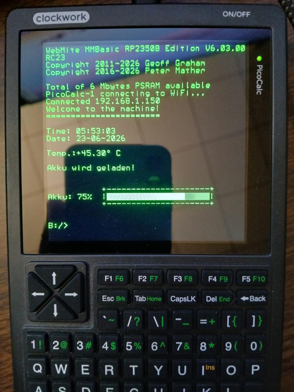

Okay, I loaded universal_flash_nuke and then RC24. Unfortunately, the behavior is the same. PicoCalc only starts up sporadically and very rarely. (No heartbeat)
toml_12953
Joined: 13/02/2015
Posts: 735
Posted: 09:55am 23 Jun 2026
  Frank N. Furter said  Something's not working right with the new version on PicoCalc.
I flashed my PicoCalc with "PicoMiteRP2350V6.03.00RC23.uf2" and loaded my mm.startup from SD card
Frank
I copied your code into my two PicoCalcs and they worked fine as shown below. Of course, I don't have a temperature sensor attached and it's warm here but not that warm!:

Is there a WEBMITE inside the PicoCalc ? toml_12953 uses a webmite.
You flashed "PicoMiteRP2350V6.03.00RC23.uf2" which is not webmite.
Could it be WIFI related ?
