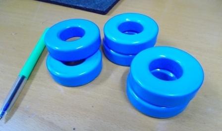

I finally had some MS226060-2 arrive from an AliExpress site that has the slowest delivery time I've seen, Site keeps saying my order is canceled due to shipping delays, then they issues a new consignment tracking number, no tracking info and then after a month or so, it suddenly appears at my doorstep via DHL.
Toroids  57.1x26.4x15.2mm
It's the last on on the list, click "View More" to expand the list (57.1x26.4x15.2mm)
These are the original meatier (smaller hole) Blue Toroids that I use, they will just fit 5 turns through a six Stack of Toroids for around 23uH, 4 turns will give 16uH.
You need 12 of these Toroid Rings to make two x 6 stack chokes at either 16uH or 23uH, the price shown is for a 3 pack.
And just to make me want to bash my head against the sharp edge of a desk
Replacing a temporary 40uH Toroid choke in one side of the "Test Inverter" with one of these 23uH chokes, which matches the existing 23uH choke in the other side, has completely eliminated the Buzz I could induce into the Toroid by fast stepping the DC input up or down. It still makes a slight Buzz as you fast step the Voltage up, but as soon AC regulation is reached, the buzz stops and the Toroid remains silent (ear against the Toroid)
Made a slight miscalculation in the Inductance, 4 turns 16uH, 5 turns 23uH.

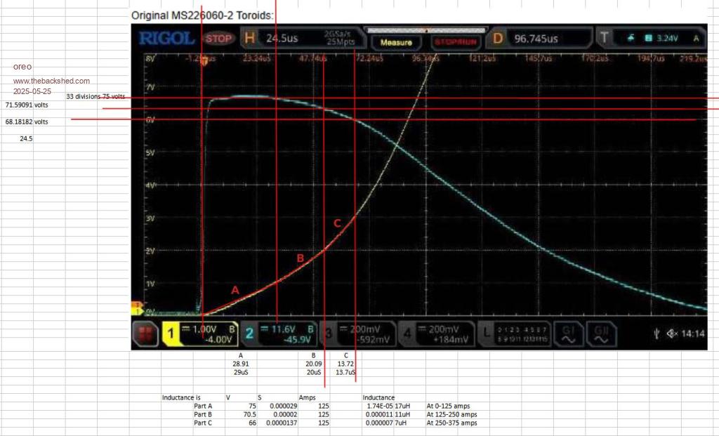

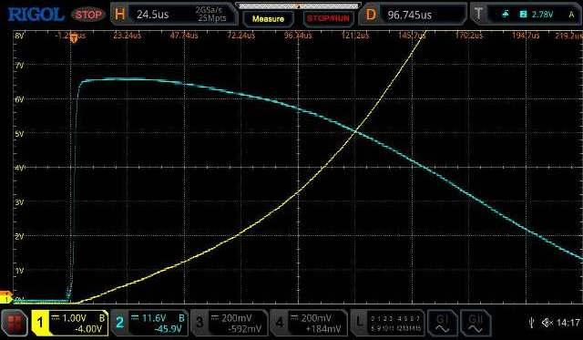

There is a difference in the Toroids, these New units are marked as FM571060A, the old Toroids are MS226060-2. I cannot find any reference to FM571060A.
They both give exactly the same Inductance for the Number of turns and are the same size.

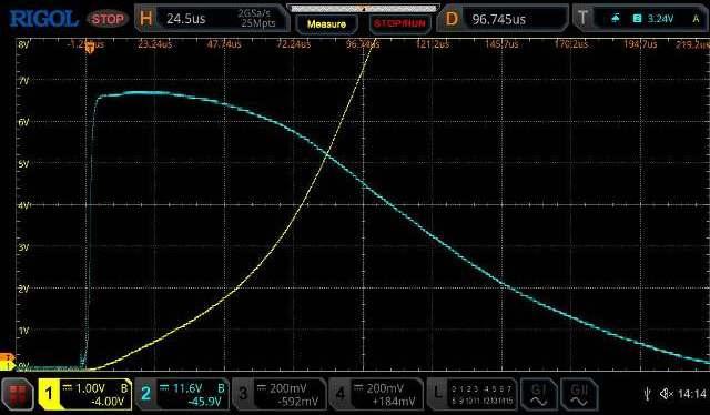

The newer units look to have a much softer curve. I have repeated the tests many times and every run is identical.
Yellow: Current 125A per volt.
Blue: Cap discharge voltage from 75V.
Original MS226060-2 Toroids:
The New Toroids:
If you compress the time scale, the second image is virtually the same as the first, it's almost as though there is a small resistance in play? I rechecked the cable, both use the same cable, everything looks identical and the display for each as shown above is always exactly the same no matter how many times I swap them into the JIG.
EDIT:
At 625A, the Cap voltage (blue) has dropped from 75V to 58V, there is still plenty of reactance left.
If the Choke is replaced with the same winding lenght cable, the Cap voltage trace is simply a narrow pulse from 50V to 0V ("almost" zero inductance).
A single power board bank of FETS handling 625A would not see anything like a short, especially as there are effectively two chokes in series with the Toroid.
So "32 FETS" and FOUR chokes in a Dual Inverter can easily handle 800A peak Induction motor start loads.
BTW: I proved that if built correctly, a single wiseguy Power board with two chokes and one Toriod, can easily handle repetitive 650A Peak start loads daily for months.

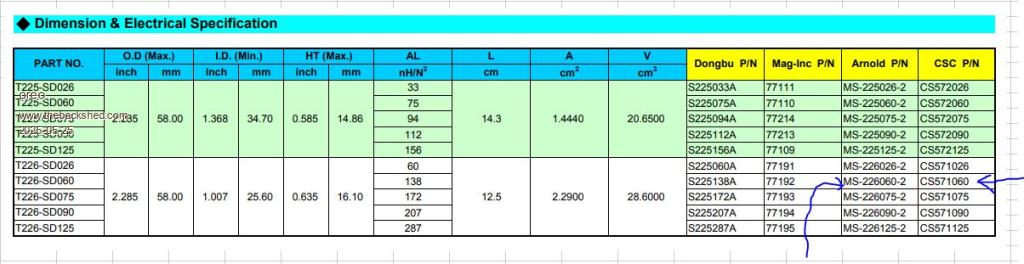

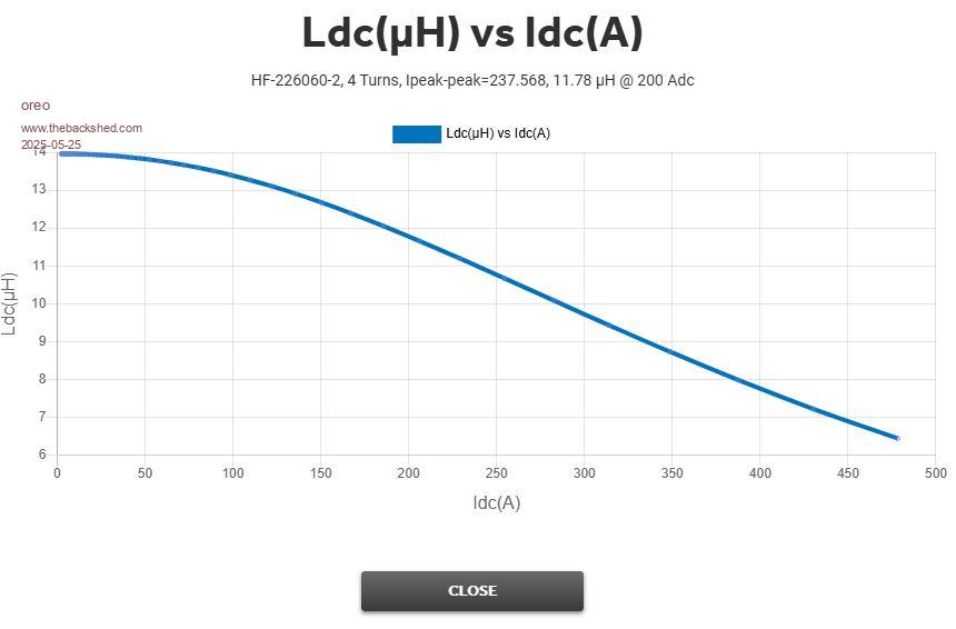

  KeepIS said  There is a difference in the Toroids, these New units are marked as FM571060A, the old Toroids are MS226060-2. I cannot find any reference to FM571060A.
Here is a cross reference I pulled from the Karson's website
Different manufacturers unfortunately use different part numbering schemes, however the FM part number seems to follow the same scheme as CSC part number.  However it is obviously not a standard sendust core material, because it saturates differently.
Let's run a few calculations.
Greg
oreo
Joined: 11/12/2020
Posts: 138
Posted: 01:42am 25 May 2025

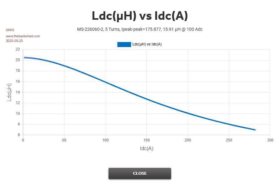

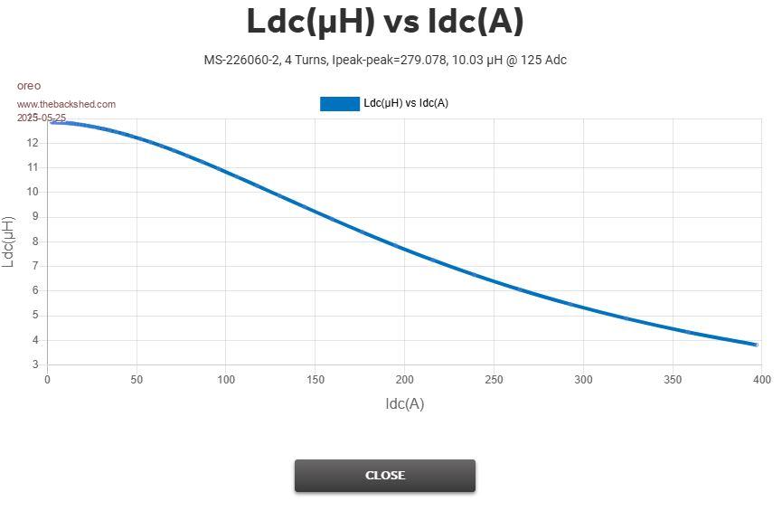

Using the curves from 6 MS226060-2 cores posted earlier by KeepIS.
Now running the same setup in the Micrometals analyzer produces slightly different results.  I do notice that KeepIS curves are a little funky in that the voltage is shown as going up for part of the curve, which is weird.
Typically the Micrometal calculations match my curve calculations but regardless we can use this as a guide.

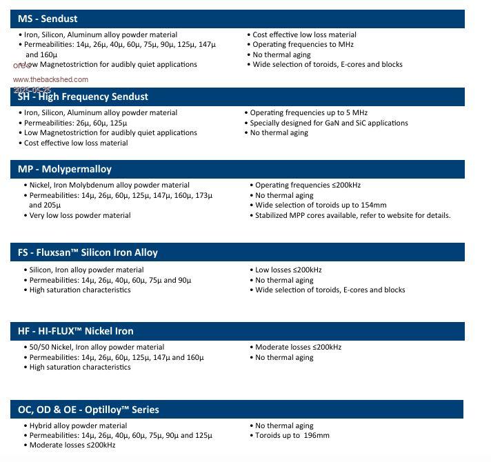

Now there are better core materials than Sendust.  Here is a list of the Micrometals (Arnold cores) materials.
Now if I plug in a HF type core into the Analyzer tool, this is the graph I get.
The FS type core produces slightly better results.
These cores saturate slower than standard sendust.
So it looks like KeepIS has discovered a core supplier that can supply cores with better characteristics than a standard sendust core.  That is good to know!
Greg

oroe thanks so much for that, I was going to ask you if you could run this through the Micrometal app as you did last time.
This confirms my calculations and the much slower saturation curve for the Latest toroids

For reference, I built this circuit, using just 1 555 (using storage scope), a voltage regulator and 6 FETS so I could crank up the current and voltage.
I have 52,000uF (overkill) and the voltage drops 1.7v after supplying 800A for 50uS.
After seeing these numbers, I can better understand how easy it is to kill FET's when you have a fault which essentially shorts the capacitor bank.
Greg

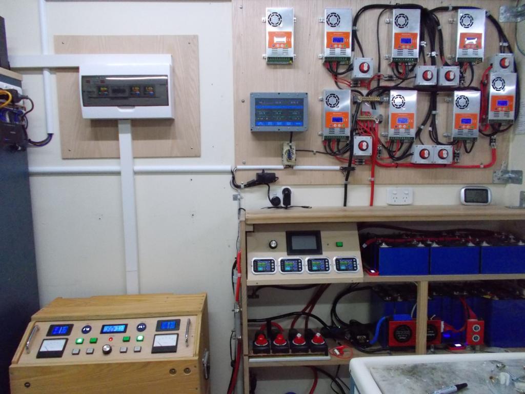

A small update on my updated kWh calculations for my 9" touch screen Inverter and solar Monitor.
In the past 10 weeks we have not used the workshop, other household jobs and three weeks with both of us down with the dreaded sudden seasonal changes from environmental toxins, combined with Westerly winds bringing God knows what along with a sudden drop to 40% humid with a cold snap, is it any wonder.
So 10 weeks running 24/7 sees the inverter doing 1.225 MWh DC input, it has tracked the Multifunction AC monitors almost 100%  (allowing for rough PF setup loss value)
Battery charge and discharge kWh has tracked almost perfectly, the small difference is because very high current Hall sensors are a little inaccurate at very low currents < 1A.
The PF is low because of the large number of small SMPS plugpacks we have, along with a few small Inverter Air conditioners, Inverter Fridge Freezers etc.
I have a "PF loss value" that I added and can adjust in the Monitor setup to get the DC kWh to track AC kWh and it averages out over time to be surprisingly accurate.
Overall long term Inverter INC efficiency (less Idle power) is running at 89%, considering the bad PF value loads over this time I'm happy with that result, this is basically worst case low power load running conditions.
We are finally starting to feel like getting back into the workshop, maybe a day or two away  The Inverter and Batteries have been left to look after themselves and have done so perfectly through all kinds of low solar conditions over this time
EDIT: I have another 5kW of solar panels ready to be installed (when I'm up for it), the charger controllers for these are fully installed and just waiting for the solar Panel cable connections.

Finally finished getting a new 10mm2 Power cable run from the Main Fuse box to the Shed, and the power box upgraded with new RCBO switches and the Generator input change over ATS switch installed. The 10mm2 was for the Generator input from the Dual Inverter located in the Shed.
Since we have been running the bigger 3.6kw 280ltr Hot water system on the Inverter, combined with cold winter mornings requiring the Reverse cycle Aircon running for about 30 minutes before getting out of bed, and an hour after that, a ceramic heater in the bathroom combined with the Washing machine on a hot cycle (2.6kW) and boiling the Jug, with other household loads I have seen over 9kW on the Inverter in the mornings, usually the morning battery level is around 64% before the sun rises, it's impossible to tell we're running off grid, and Inverter running cold BTW.
When I started the journey a few years ago, I never thought it possible to build a DIY Inverter good enough to power everything without caring about how many lights are left on, or how many times you boil the jug or how many late night movies you watch, or run the Aircon all night or use Hot water like we are on Mains AC, and more importantly (impressively), not worrying about how much power we are actually drawing from the Inverter at any given time, knowing that it can handle everything I can throw at it with ease, providing the batteries can keep up with it at night
Below: The pix has optical distortion and is a bit blurred, sigh, but this shows the Solar wall with the eighth 60A Solar regulator waiting for the last solar panel array, which is sometime down the track as the Solar in-feed tariff from the old 2010 system runs out in two years, at which time we get charged to in-feed, so the old system will be junked, if it lasts that long, and a set of new panels will be installed to also feed the low voltage solar wall. We will likely have no trouble running totally off grid in Winter under bad Solar conditions, we can do that now with the occasional day or two of really bad weather.
A small wall mounted power cabinet above the Inverter has two AC displays to monitor power from the Dual Toroid outputs, a display for combined 240vAC output and a separate higher quality kWh meter to verify and accurately log total kWh.
There are two output cables exiting the top of the Power case, one is a switched Inverter 240vac output (Generator) via a 10mm2 cable running to the main fuse box for powering the entire property. A separate switched output allows powering just the Emergency circuits and Shed (workshop) in the case of an extended Mains power outage under prolonged bad Solar Weather conditions. Everything is automatic via an ATS unit in the House Fuse Box and another ATS in the Shed Fuse Box, each controlled by two 45A Circuit breakers (switches) in the Inverter wall Power case.
The only things to complete the system now are four heavy duty metal Battery Boxes on castors, should only take an hour or two to transfer all the cells, BMS's etc across.
