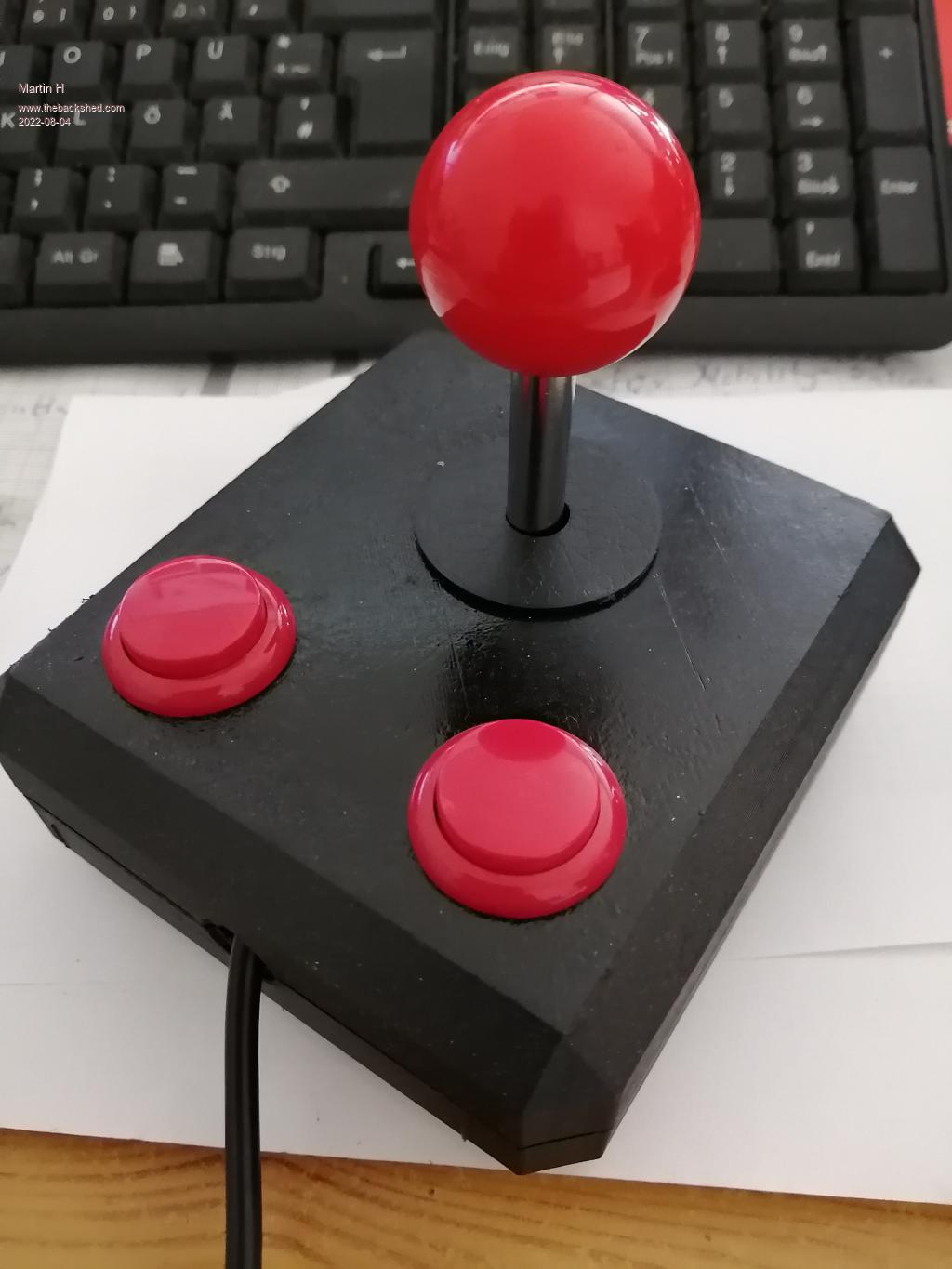

Just Printed this one https://www.thingiverse.com/thing:2890310
because I had this 4 way microswitch arcade joystick lying around from a previous Ali Express order
I just had to adjust the diameter of the buttons before I printed the top.

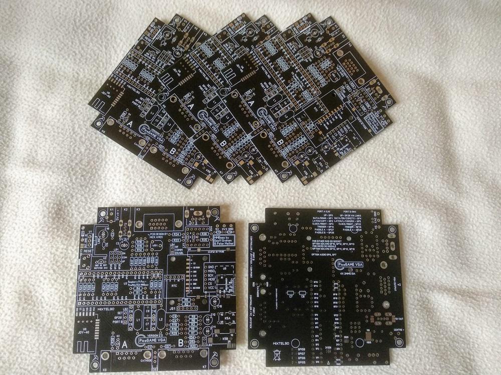

New deliveries from JLCPCB, some v2.0 PicoGAME PCBs:
One of them is of course yours if you want it Mick ?
Probably going to be a couple of weeks before they hit the workbench, but expect queries regarding the BOM in the meantime.

I soldered my 3d printed joystick yesterday.
It's just not entirely clear to me, which pin should be the corresponding one.
Plus 3.3 V (7) or ground (8)
