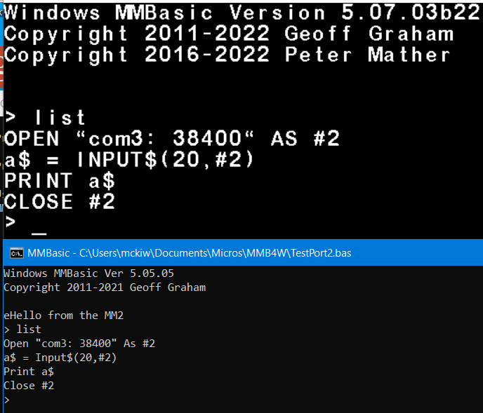

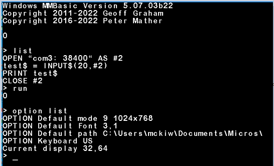

Sorry Peter, This what I see. I am running it from MMEdit but I don't see how that could affect anything.
Same program with MMBasic DOS
This program still crashes MMB4W.
OPEN "com3: 38400" AS #2
input #2, test$
print test$
CLOSE #2

The zero comes from running the program at startup, MMEdit runs the program when it starts MMB4W. It's the same zero that you see after I type RUN. I have no strange OPTIONS set I believe.
One thing though, the program being run is not in my default directory it is in a subdirectory of /micros > /micros/MMB4W but I can't see how that can have any bearing. But...
Sorry off to bed now.

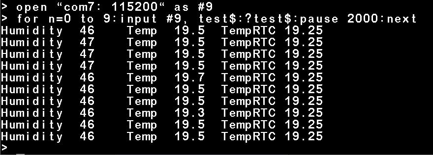

Output from another program.

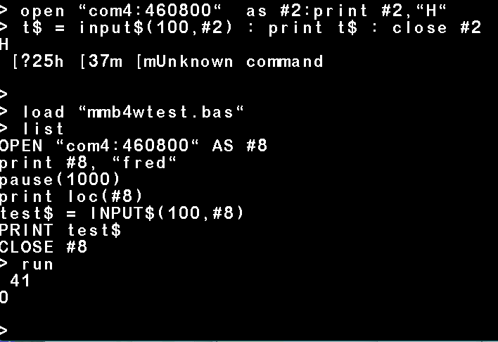

Sorry, but I still can't get it to work.
Works OK from the command line as per Phil but not in a program.
Running in a program does send to the cmm2 and the receive buffer gets the data returned but unable to retrieve from the rx buffer.
OPEN "com4:460800" AS #8
PRINT #8, "fred"
PAUSE(1000)
PRINT LOC(#8)
test$ = INPUT$(100,#8)
PRINT test$
CLOSE #8
Edit:
If you use
INPUT #8, test$
it works OK so the problem is with the INPUT$(nn,#x) command.

I think I have gone as far as I can with this.
PRINT #8, "fred"
PAUSE 1000
atest$ = INPUT$(100,#8)
PRINT atest$
CLOSE #8
works
PRINT #8, "fred"
PAUSE 1000
PRINT test$
CLOSE #8
fails
The only difference is the second code uses test$ as the variable name.
Baa Humbug...

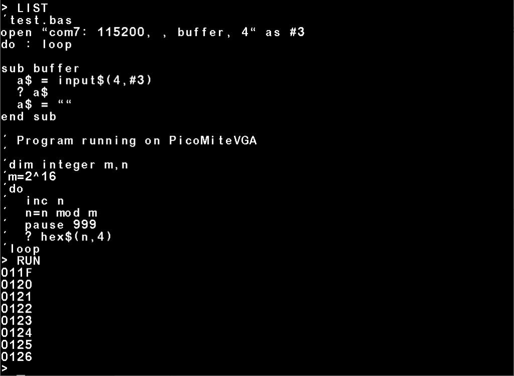

Posted: 02:25am 22 Dec 2023
This works quite well. Sending Bin$ to make it easier to see what is happening. Change to Hex$ for practical use, adjusting receive end to match.
'test.bas
open "com7: 115200, , buffer, 16" as #3
do
 if flag then
  flag = 0
  ? a$
 endif
loop
sub buffer
 a$ = input$(16,#3)
 flag = 1
end sub
close #3
end
' Program running on PicoMiteVGA
dim integer m, n
m = 2^16
do
 inc n
 n = n mod m
 pause 999
 ? bin$(n,16)
loop
end
Edit.
Edited 2023-12-22 13:00 by phil99

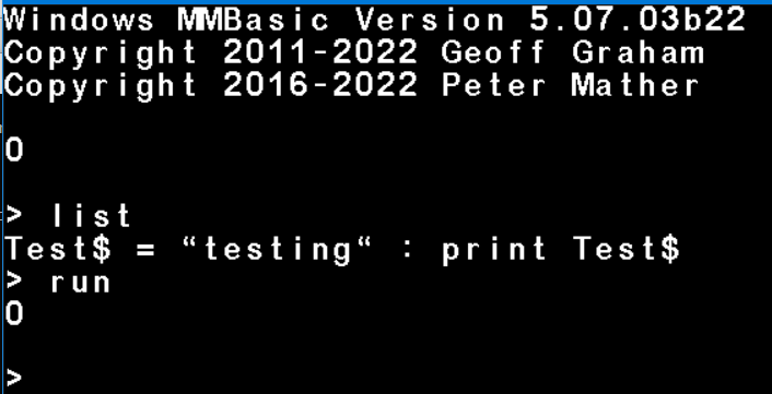

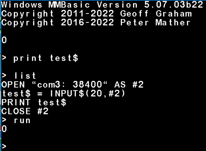

Hmmm. The plot thickens. Maybe the variable name TEST is part of some internal debugging code:
The first zero is because the program is run immediately it is loaded.
It does work on MMBasic DOS.
Turbo46
Joined: 24/12/2017
Posts: 1694
Posted: 03:16am 22 Dec 2023

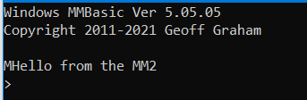

So I changed the name from test$ to a$ and ran it again.
As you can see it doesn't print zero now but prints nothing. Again it does work on MMBasic DOS.
I wonder if MMBasic DOS empties the com buffer as it opens the port while MMB4W doesn't?
From that and TassyJim's test it does seem the TEST is some kind of internal variable that overrides it's use in a program.
