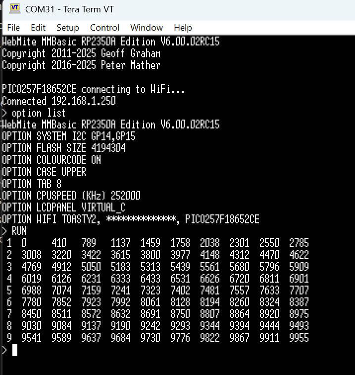

This was a problem in WebMiteRP2350V6.00.02RC14 and is still a problem in RC15. When I run the logtable below, the processor reboots at about 9955.
110 LET W=0
120 FOR X=1 TO 9
130 PRINT X;
140 FOR Y=0 TO 9
150 LET Z=(10*X+Y)*.1
160 IF ABS(10^W-Z)>.001 THEN 210
170 LET T=INT(10000*W)
190 PRINT TAB(6*Y+4);T;
200 GOTO 230
210 LET W=W+.0001
220 GOTO 160
230 NEXT Y
240 PRINT
250 NEXT X
260 END

  Quote  When I run the logtable below, the processor reboots at about 9955.
Put some diagnostics in and work out which command is causing the problem and what the variables are at the time - then report. Sounds like a overflow or divide by zero or similar that isn't being trapped
Can't replicate
Edited 2025-04-16 04:26 by matherp
I'm using a Dell wireless mouse connected to my Core i9 ASUS motherboard. The PicoMite 2W is connected via a USB 3.0 port.
When I turn TRACE ON, before the processor resets, I get the message:
Error: Invalid address - resetting
If I change line 170 to
T=INT(99*W)
the program completes. If I change it to INT(100*W), the crash occurs.
W=0.9956, x=9, y=9, z=9.9, t=99
In the statement
170 T=INT(nn*W)
Any number, nn, over 99 makes the crash occur.
Original program:
110 LET W=0
120 FOR X=1 TO 9
130 PRINT X;
140 FOR Y=0 TO 9
200 GOTO 230
210 LET W=W+.0001
220 GOTO 160
230 NEXT Y
240 PRINT
250 NEXT X
260 END

Don't understand. As per my previous post the program as you listed it works fine for me 170 LET T=INT(10000*W)

Reboot problem discovered!
The problem was that I had
OPTION ESCAPE
SUB MM.END
 PRINT "\n\nEND PROGRAM\n"
END SUB
in the library. I don't know why that should cause a program crash but when I removed it from the library, the logtable program stopped crashing.
When I put that in the program itself, it crashed again.
Even a null sub with no print statement in it
SUB MM.END
END SUB
will make the program crash.
Edited 2025-04-16 05:12 by toml_12953

  Quote  This was a problem in WebMiteRP2350V6.00.02RC14 and is still a problem in RC15. When I run the logtable below, the processor reboots at about 9955.
This was a bug that I've now fixed and will be in the next version. I asked Cortana to rewrite your code in "modern" Basic and this is the result
