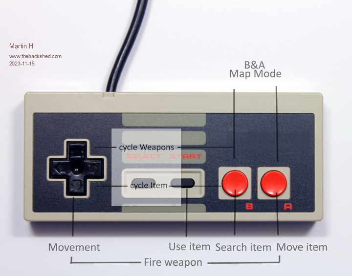

the goal would be the SNES Controller,which I dont have right now.
source: PetsciiRobots user Manual
if they work with 3.3V The way it is connected is identical to the NES, only the software has to evaluate 12 bits instead of 8,
The controls on the GameMite or NES controller are already a compromise, as there are too few buttons, but they are still playable
(Control via a single Atari joysticks is not provided because they simply have too few buttons)
for control, you can always use the keyboard instead of the controllers
Cursor Move
A W S D  Fire
Z        SEARCH
M        Move
SPACE    USE
TAB     cycle Map Mode
F1       cycle through weapons
F2       cycle through items
Edited 2023-11-15 16:30 by Martin H.

  Volhout said
I checked the NES controller, and it works in this version (set nesPG1=1 in line 5).
Happy gaming....
somhow the changes in the c2k$ Function didn't made it to the D Version?!
so the combination of buttons didn't work
NES delivers the output in a different order, so the possible combinations have to be queried at the moment. It's not elegant, but it was important to me that it works at all. so for Using NES Controller it should be like this:

Posts: 6199
Posted: 07:17am 15 Nov 2023
Oops.. Will be in the next release.
I just checked walking around and not the button combinations.
I used the NES controller depicted in the post above. It was send to me by Tom, to test for the "9'th clock" that some controllers need.
Good that you found it...
Edited 2023-11-15 17:19 by Volhout
