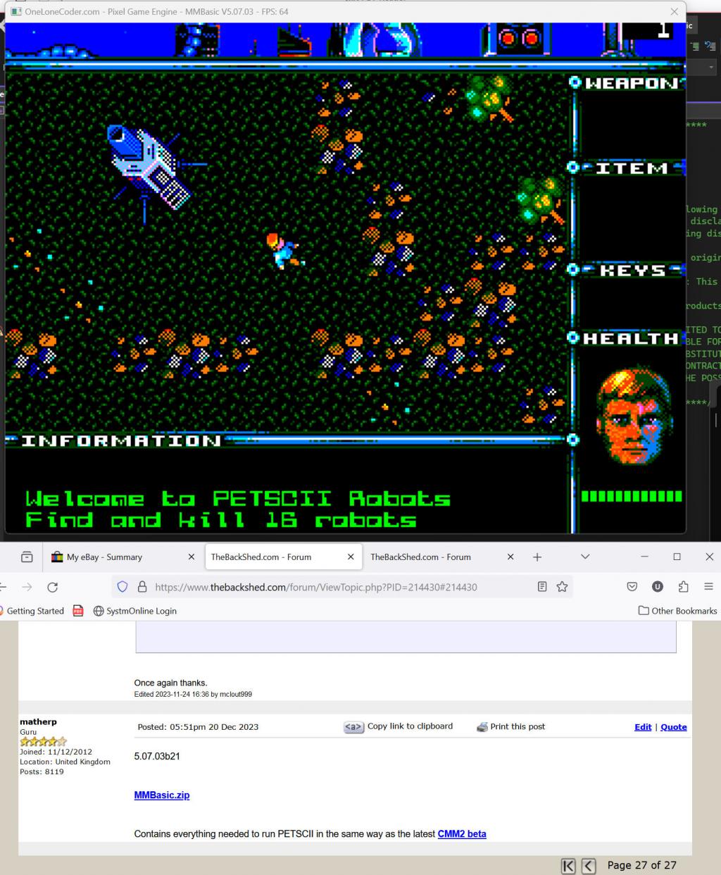

Posted: 05:51pm 20 Dec 2023
5.07.03b21
MMBasic.zip
Contains everything needed to run PETSCII in the same way as the latest CMM2 beta
Edited 2023-12-21 03:53 by matherp

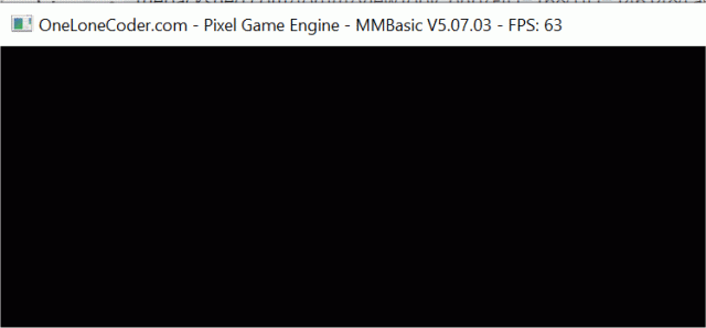

For many months now across at least three versions of MMB4W, I get just a blank screen, like this:
I don't have a ">" prompt, and no matter how many times I hit <Enter>, I never get one. CLS RGB(RED) has no result. The window closes if I type "quit" and <Enter>.
I've deleted the .options file in MyDocuments without any change in behavior (it's recreated when I run MMBasic).
I'm running Win10. MMB4W worked for me for a long time after it was introduced. I have no idea what changed to cause this current behavior, and no exact memory of when it started.
Any ideas about how I may fix this?
EDIT: I've just found that if I type MODE 2, I get a prompt, and CLS RGB(red) and CLS work.
EDIT2: And now, everything runs. What weird state was I in that was fixed by entering MODE 2?
Edited 2023-12-21 08:44 by lizby
Posts: 12058
Posted: 10:44pm 20 Dec 2023
Press Auto on the monitor
Posted: 10:51pm 20 Dec 2023
  matherp said  Press Auto on the monitor
This is a laptop.
