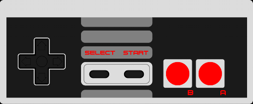

I added NES Style Controller on port A (the Left port) of Mixtel90s PicoGAME VGA Board
pet24an.zip
Controlls are translated like on Game*Mite
But         Returns Key  Action
"DOWN "         Chr$(129) 'down
"UP "           Chr$(128) 'up
"LEFT "         Chr$(130) 'left
"RIGHT "        Chr$(131) 'right
"BUT-A "        "m"       'Move
"BUT-B "        "z"       'Search
"START "        " "       'Start
"BUT-A & BUT-B" Chr$(9)   'Tab
"BUT-A & DOWN   "s"       'Fire Down
"BUT-A & UP "   "w"       'Fire Up
"BUT-A & LEFT"  "a"       'Fire Left
"BUT-A & RIGHT" "d"       'Fire Right
"BUT-B & UP"    Chr$(145) 'F1
"BUT-B & DOWN"  Chr$(146) 'F2
"SELECT"        Chr$(27)  'ESC
FOR GAME*MITE SET
Const nesPG1=0 'Nes Controller on Port1 Pico Game Board
at the Start of the Program
Have Fun
Edited 2023-11-14 02:54 by Martin H.

Looks good, will try with controller soon on PicoGameVGA

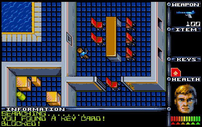

to make the logo more consistent with the Robots theme
Of course in 121 RGB
Edited 2023-11-14 05:43 by Martin H.

On pet24b the NES controller on my PicoGameVGA does not work.
In the startup menu I can press UP/DOWN and START, but in the game it does not work.
pet24b.zip

  Volhout said  On pet24b the NES controller on my PicoGameVGA does not work.
You just missed one of my changes
change
   'player input through keyboard, clearing buffer, check loop time
   k$="":Text 290,0,Right$("00"+Str$(Timer,3,0),3)
     tmp$=Inkey$
     If tmp$<>"" Then k$=tmp$  'keep last valid key
   Loop Until Timer>h_beat
   Timer =0
   If Game_Mite And k$="" Then k$=c2k$()
to
     tmp$=Inkey$
   Timer =0
   If k$="" Then k$=c2k$()
Function "c2k$()" (the translation of Controller Input to Keypress) should now allways be called, if there is no Keypress.
