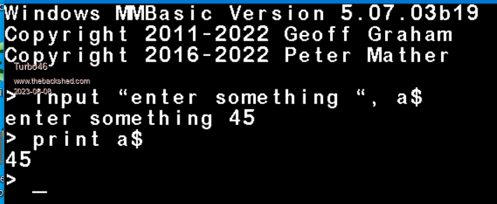

Thanks Phil and Jim, I'm not sure what you mean by:
  Quote  MMB4W does do that.
But I get this when I enter it at the input prompt:
Which NOT what I see when doing it in a program.

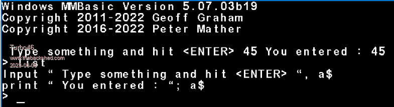

Thanks Peter, I did expect that at the command prompt but I never have seen any BASIC program not do a new line after the response to an INPUT statement.
Posted: 08:24am 08 Jun 2023
I think Bill is correct, MMB4W is misbehaving:
I typed "foo" at the INPUT prompt and then Enter ... it should have inserted a newline and printed the second "foo" on the next line.

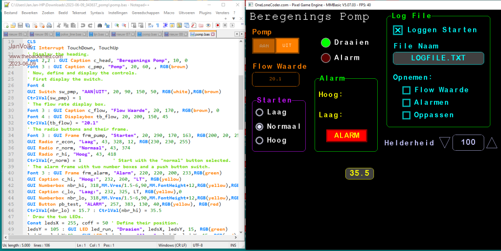

I've been doing some testing with the GUI commands for MMB4W and it works very well so far.
That is why I do not understand that all these extra settings are not included in the standard manual if you want to quickly consult the manual and then run into all kinds of references.
For myself I translated the pdf files into Dutch because my English is not so good with many examples.
I also adapted Notepad++ for the Syntax to MMB4W which is now a party for programming with MMB4W.
See here the example program by Geoff Graham from 2015 which works perfectly with MMB4W and you will not easily see the extra functions and commands with only the MMB4W manual.

Posted: 07:19pm 08 Jun 2023
An example of what this looks like for me.

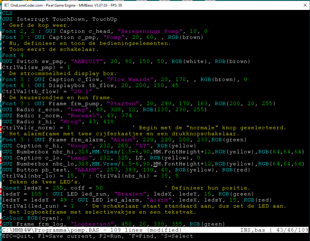

Posted: 07:56pm 12 Jun 2023
Peter,
There may be more like MM.Fontwidth and MM.Fontheight?
See screen print.
Jan
Posts: 12058
Posted: 09:48pm 12 Jun 2023
Please stop posting about editor colouring. Many commands in the CMM2 and MMB4W are converted into other commands by the pre-processor. Therefore they are not colour coded. It is what it is and remember it is free
Posts: 9238
Posted: 06:34am 13 Jun 2023
If the "wrong" colours put you off it's easily fixed with OPTION COLOURCODE OFF. ;)
More to the point, even if CtrlVal(#ref) is listed as a command, it's always treated as a single-dimensional array - it is actually a value. To colour it any differently probably introduces more confusion, not less. Mind you, that's just me. :)
