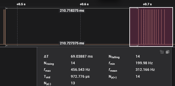

Thank you for the new RC21. I am though still seeing odd behaviour.
Much the same program as before, same options also.
Also, thank you so much for the StallGuard as found in the TMC2209! I was starting to wade through the TMC data sheet to figure out how to use it, and suddenly, there it is, already in the firmware! WOW!
> list all
Const M_EN = MM.Info(PINNO GP30)   ' stepper enable
Const M_STEP = MM.Info(PINNO GP26) ' stepper step
Const M_DIR = MM.Info(PINNO GP27)  ' stepper direction
On error skip
Stepper Close
Stepper Init
Stepper Axis A,M_STEP,M_DIR,M_EN,,16,20000,1000
Stepper Position Home
Stepper Run 1   ' disable stepper when not moving
Pause 200
For i = 1 To 100
 Stepper gs "g1 f12500 g91 a" + Str$(i)
'  Stepper gs "g1 f12500 g90 a" + Str$(i)
 Do : Loop While Peek(stepper active) > 0   ' wait for motion to stop
 Pause 200  ' wait some more
 Print i,Peek(stepper a)
Next i
I put a logic analyzer on the STEP pin to see what's going on. Some move requests loose 2 steps. The capture below is for the first move of 1 unit. There are only 14 step pulses generated. There should be 16. (Note also the 3 stray pulses at the beginning, when the stepper system is initialized. I didn't check the state of the enable pin during these pulses - sorry.)
Here's a comparison of the output with RC20 and RC21. No change.
"x" on the right indicates a move request with 2 missing pulses. The error is consistent each run. "Pulses out" is the pulse count from the logic analyzer.
I haven't seen an error on moves above 32.
Note my configuration of 16 steps per "unit". This means a move of 100 on the A-axis turns the motor exactly once. Also, X,Y and Z are not used and unconfigured.

{Observation: A-axis should be at 820 at the end. 1.5 is missing.}
