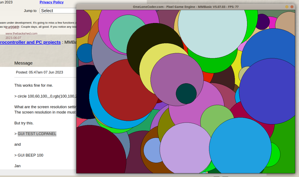

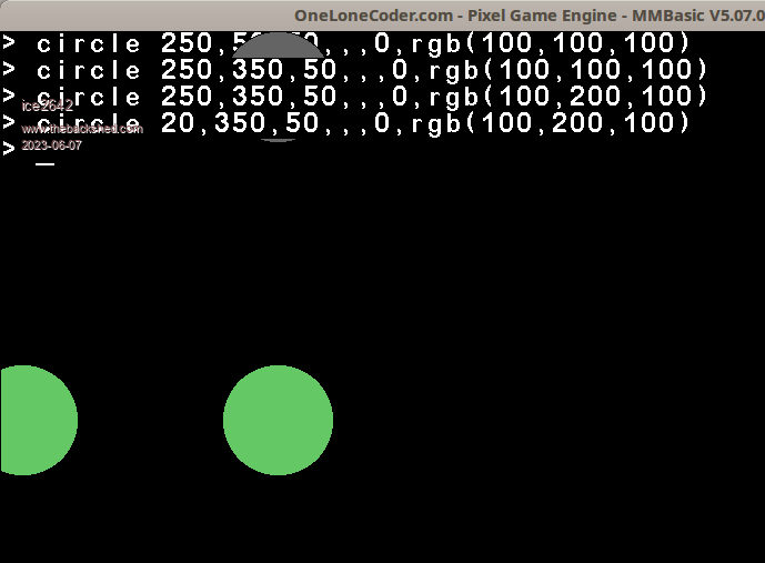

This works fine for me.
> circle 100,60,100,,,0,rgb(100,100,200)
What are the screen resolution settings in windows and what is in the option list?
The screen resolution in mode must be smaller than in the windows settings.
But try this.
> GUI TEST LCDPANEL
and
> GUI BEEP 100
Jan

Hello, both tests work fine.
The options was default, I just unzip and run. but the path go to my documents.
The edit still not work

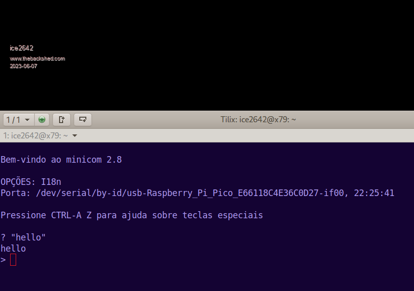

And the ( " ) character not work. This occurred in gfxterm terminal using raspberry pico too.

After test (gui test lcdpanel) , the circle start work.

The same happens using gfxterm using the pico card over usb.
in putty it works normally.

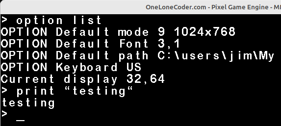

Posts: 6626
Posted: 04:06am 07 Jun 2023
The only change I made to the options is
OPTION KEYBOARD US
Tested under Wine on Mint-Mate in a VM on Windows11

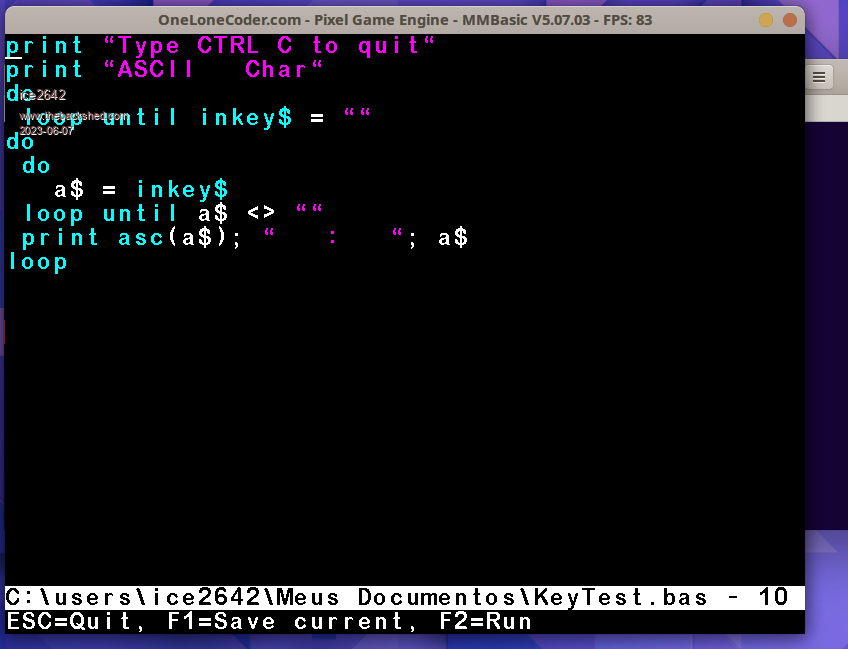

OK, this might help:

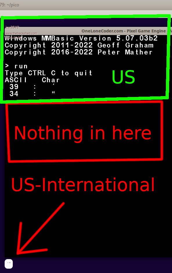

  Quote  print "Type CTRL C to quit"
print "ASCII   Char"
do
 loop until inkey$ = ""
do
 do
   a$ = inkey$
 loop until a$ <> ""
 print asc(a$); "   :   "; a$
loop
If you can copy that code into a text file and save it as "KeyTest.bas" and drag it into MMB4W it will wait for you to hit a key then print the ascii code (decimal) and the printable character.

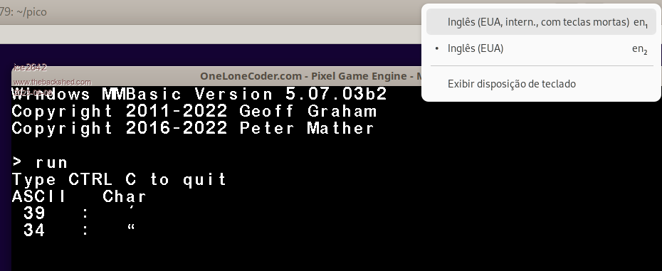

Posted: 07:04am 07 Jun 2023
Maybe an interaction with a setting for Brazil ... I wonder what knows or thinks it's not USA (or UK) and what effect it has?

  JohnS said  Maybe an interaction with a setting for Brazil ... I wonder what knows or thinks it's not USA (or UK) and what effect it has?
You are right.
The problem is the set up of US international.
I set it to standard US and the problem is gone, I can now type " without any problems.
It would be interesting to find out why this happens, as other variables in international English may be a problem.
But if anyone else has the same problem, the solution is to add the normal US keyboard and when using MMBasic, activate it.
Thank you

I don't think any MMBasic supports US International keyboard at all, only US (standard, which is also used for Australia & New Zealand), UK, DE, FR and ES.
Although I'm in thee UK I usually end up using a US keyboard and remembering which characters are different. You pay extra for UK keyboards ...

  JohnS said  Excellent - working is good!
I wonder what would happen if you changed the setting back while (*) you have an MMB4W program running (perhaps the one above using INKEY)?
If it changes even when the program is running you might be able to hit the " key and see what actual code it is producing when in the country code setting you originally had.
OTOH if it works now... maybe just keep it?
(*) I was going to put whilst but that's a bit hit-and-miss for non UK-English people
I make the test, change on the go, the "stop work.
The green US , the Red US-International.
MMBasic 5.0707 on PicoMite VGA

  Mixtel90 said  I don't think any MMBasic supports US International keyboard at all, only US (standard, which is also used for Australia & New Zealand), UK, DE, FR and ES.
It seems it doesn't even support as per the terminal. The windows version does not.
The simplest way for anyone using an international US keyboard is to leave the 2 configurations in the system and switch to the default US when running MMBasic.
The funny thing is that connecting through Putty or minicom works without any problem, so it can be assumed that it is not MMBasic, but the terminal used. In this case, the windows version uses a game engine to display the graphics (Pixel game engine) and I think that it is having a problem with the keyboard, the same thing with gfxterm that also had this problem, but I don't know if the same engine was used .

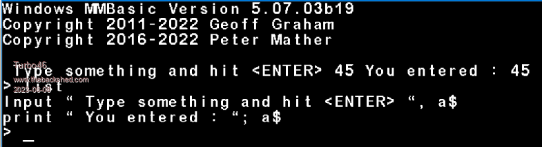

Can someone please confirm that I am not the only one seeing this:
The program:
Input " Type something and hit <ENTER> ", a$
print " You entered : "; a$
produces this output:
MMB4W does not 'print' a CR/LF after an INPUT statement but it does after a PRINT command. My OPTIONs are exactly the same as TassyJim's above except for the default path.
The same thing in MMBasic for DOS is correct
  Quote  Windows MMBasic Ver 5.05.05
Copyright 2011-2021 Geoff Graham
Type something and hit <ENTER> 45
You entered : 45
> list
Print " You entered : "; a$
I can work around it of course but I would like to know whether it is MMB4W or me doing something stupid.
Posts: 3416
Posted: 04:43am 08 Jun 2023
Yes, MMB4W does do that. So do PicoMite and MM+
- only tested at command prompt not in a program, but they should be the same.
