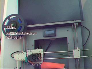

Posted: 10:53am 16 Jun 2026
  matherp said  V6.03.00RC20
UI changes to the FM command - see the chapter in the manual
Fixes bug in LIST SYSTEM I2C
Camera command now supports 320x240 capture for applicable RP2350 versions (now including HDMI and HDMIUSB)
The camera works excellent with HDMIUSB. Colours look really good and natural and the picture is quite sharp with good Autofocus. Thank you for the improvements!
If it would work in terms of speed a buffer would make sense to me if PSRAM is present.
List system i2c works fine for me.
FM and its help look clear. When copying files the status of the copy process should be displayed immediately. I tend to wonder if I pressed the button correctly..

> mode 4 : camera open gp24,gp25,gp26,gp27,gp28,gp32,qvga
> do : camera capture : loop until inkey$ <> "" : save image "test1.bmp"
The picture on the HDMI monitor look also very nice in QVGA:
Posts: 12056
Posted: 11:34am 16 Jun 2026
PSRAM is far too slow
