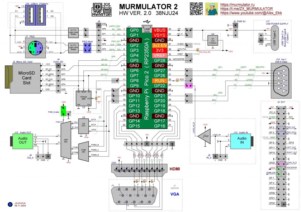

OK! With this latest update using the OPTIONS settings I was able to fully configure PicoMiteHDMI for my new MURMULATOR2 HW ver.2.0 board
Thank you very much for your work and attention!

Posts: 6198
Posted: 10:48am 24 Nov 2024
Hi javavi,
Quite interesting that you, living in Ukraine, being bombed by Russia, are buying Russian murmulators. I expected people from Ukraine would avoid using Russian tech.
Maybe the war is not as severe as European media show. Maybe we (Europeans) are very much manipulated in thinking there would be hatred and grudge.
javavi
Joined: 01/10/2023
Location: Ukraine
Posts: 622

Posted: 11:36am 24 Nov 2024
  Volhout said
Quite interesting that you, living in Ukraine, ....
Hi Volhout,
The war is real, you Europeans haven't even dreamed of anything like this since 1945, they just drove the orcs away from me a little and Russian planes don't fly over us anymore, but they bomb and attack the front lines, and they also launch drones and missiles at us almost every day.
I know the author of the MURMULATOR and he's a nice guy despite being Russian. Well, in general, not all Russians are hardcore rashists, but imperialism and nostalgia for the USSR can be felt in everyone.
If for us the collapse of the Soviet Union in 1991 was a celebration of gaining independence, then for russia it is perceived as the greatest catastrophe of the country of the Soviets. This is where the roots of revanchism and rushism grow, and the top elite played on this and apparently got carried away, that they believed in themselves. This is the work of propaganda from the subordinate media.
I didn't buy the Murmulator board, but I ordered parts from JLCPCB & AliExpress, and this is available here.
Regards, javavi
Edited 2024-11-24 22:00 by javavi

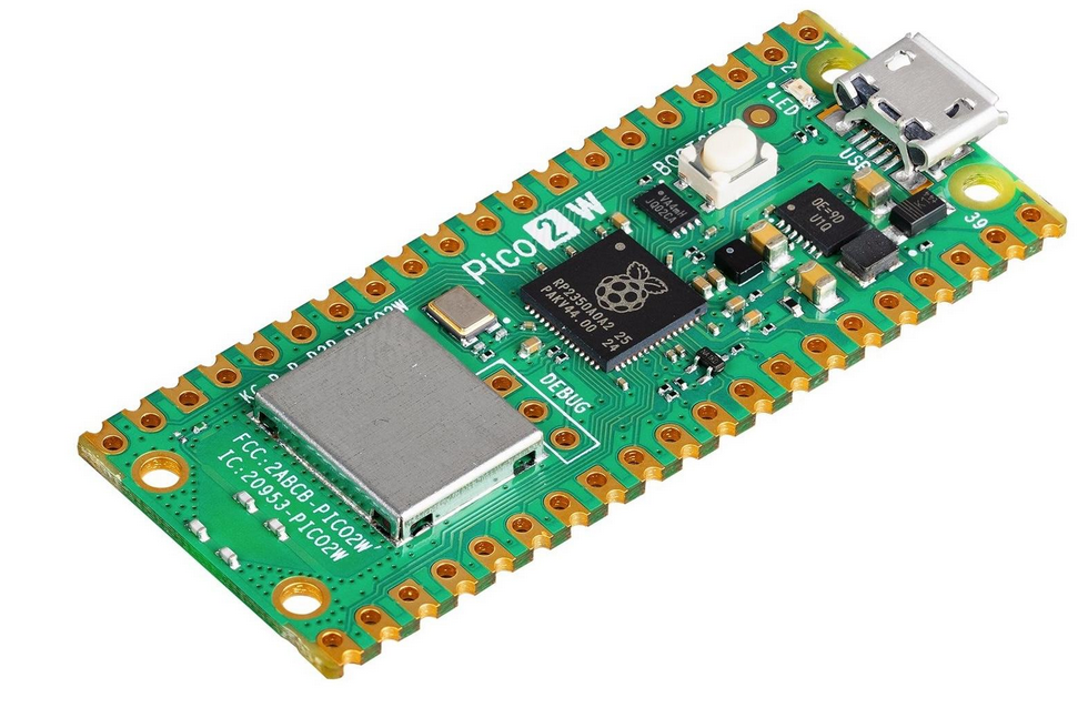

Does it support wireless?
just ordered
-andreas
