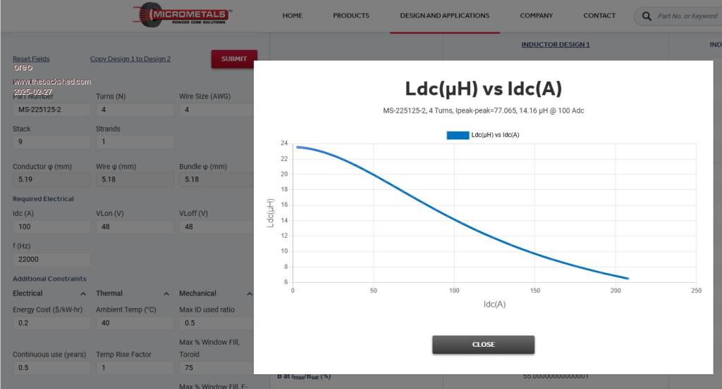

Thanks for the link for the Sendust cores.  In Canada, the price comes up as $6.60 plus $9.45 shipping (CAD), but as you add more cores, the shipping just goes up by $1 each.
(until you hit 12 cores when the shipping goes up by an additional $60)
So to order 11pcs it works out to $8CAD or $8.84 AUD each which is the best price I have found around!
I tried ordering this size core earlier off an EBAY vendor, but they ended up not actually having the advertised cores and sent me MS184040-2 cores instead.
They refunded me, and I may use the cores for something, but obviously not ideal.
On another note, when I enter a stack of 9 pcs of this core (MS225125-2) with 4 turns in the Micrometals inductor Analyzer,
I am not seeing the inductance at the higher currents you are mentioning.
On my previous builds using 3xMS157060-2(Sendust) and 4xT250-40(Iron Powder) the inductor Analyzer numbers were surprisingly close to the numbers
I measured using a storage scope and high current source.  Obviously what you have is working well, so just wanted to confirm that you are using
these cores with just 4 turns.
Here is the current vs inductance curve generated for a stack of 9 MS225125-2 cores with 4 turns.
I have double checked the core weights and sizes between the Micrometals core and the Aliexpress core and they match.  So I am a little stumped with why the difference.

That's interesting, I'm measuring them with a current source of up to 700A and a DSO, while they are not "quite" as good as the meatier 6 core stack (not available) they are close.
These are measured with a high current hall effect sensor and confirmed against a resistive shut for Hall Sensor transient response and indicated current.
Two chokes have been repeatably subjected to almost 600A daily for over a year, and as you say, they are working well, in this dual inverter they now see 600A peaks across 4 chokes.
It's a shame that we can't get the original cores, and cores in general at a decent price.
Edit: From memory I calculated around 9uH at full current for a single 9 core choke with original thicker cores, if the Sim is correct then I was close, 7uH @ 200A single choke, two chokes would be round 14uH at 400A, over 20kW input surge.
Edited 2025-02-27 13:36 by KeepIS

Are you seeing inductance go down when the DC current goes up?  If not, then these must not be Sendust cores.
Greg

Of course, why would they be 23uH at zero current and 9uH close to saturation.
They are Sendust, the correct mix is stated.

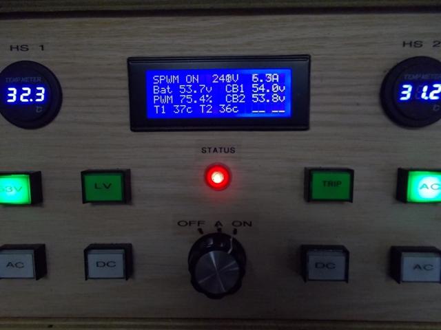

I came back to the house after a morning walk to find no power (off grid), the Inverter was averaging around 6kW when I left.
Looking back at the LOG, an Unknown fault on the AC wiring had caused the DC input to run over 17Kw, over 30kW peak, into the Inverter for at least 6 minutes.
I was glad to find the Inverter was still happily idling with no error and showing 243VAC output, the Inverter AC output runs to a double pole DZ47-C63 circuit breaker, and this had tripped after around 6 minutes running time at high AC current.
I switched the 63A circuit breaker back on and it instantly tripped again.
This time the Inverter also tripped with an over-current fault indicated on the LCD.
Two DC input current trip LEDs were ON, one on each DC input feeding two Power boards, but no AC current trip, Inverter AC current trip is set at 73A from memory.
I reset each DC trip indicator/button and pressed master reset - leaving the 63A AC circuit breaker off.
The Inverter powered up perfectly, tough little bugger.
