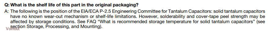

Vishay comment on shelf life of tantalum capacitors:
You may check them on leakage, but good chance they are still good after 40 years.
