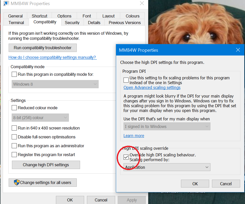

Do your laptops run high DPI.
If so, that is the problem (or it is with my laptop)
I created a desktop shortcut and then edited it's properties
Previous versions of MMB4W were OK
Edit with more information:
My laptop is running Windows 10.
On my laptop the MMB4W opening screen is too big for the display. With earlier beta's the sign-on text is off screen and just a hint of it is visible.
Turning off DPI settings makes life better.
The latest beta gets as far as opening the main window and stops.
I can't tell if any of the sign-on text is there.
There is no response to the keyboard.
Turning off high DPI works nicely for the latest beta and I prefer it that way.
Edited 2023-05-31 14:11 by TassyJim

Posted: 10:20am 31 May 2023
Thanks Jim. I am running Win 10 and turning off high DPI gave me a black panel instead of white but no banner and the keyboard was dead. I have gone back to the October version V5.07.03b12 which seems to work OK. It is a shame I cant't run the latest version though.
Phil

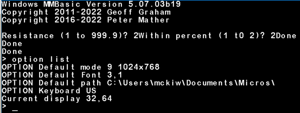

MMB4W Bug
MMB4W does not 'print' a CR/LF after an INPUT statement but it does after a PRINT command. The following code demonstrates.
 do
   input "Resistance (1 to 999.9)? ", r
   if r = 0 then end
 loop until r =< 999.9 and r => 1
 do
   input "Within percent (1 t0 2)? ", tol
 loop until tol => 1 and tol =< 2
 print "Done"
 print "Done"
 print "Done"
The result:
In addition: the copyright date needs to be updated.

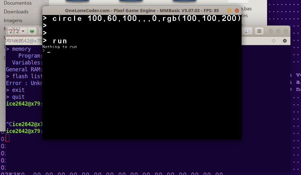

I do not use windows a very long time, but I try it on linux ubuntu 22.04 and wine 5 just for test.
The MMBasic window open, but when I press F1 for editor, it list my Documents directory.
basic commands, like print, do , loop, etc... work, mode 2 change the window, but no graphics.
Best Regards,
