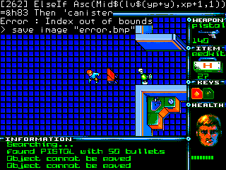

since v 23 the program runs into an error with the program from time to time.
(not just with my last version)
'no comment

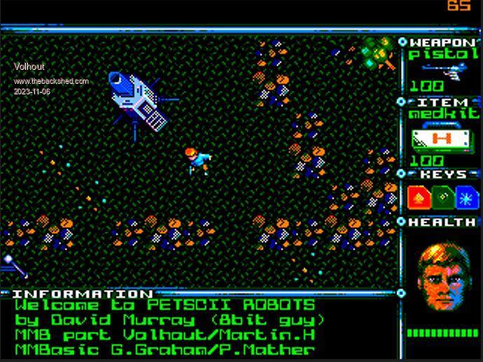

I like how it is growing from this
to this
