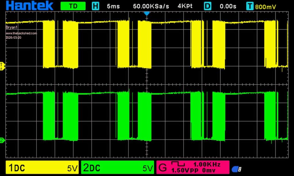

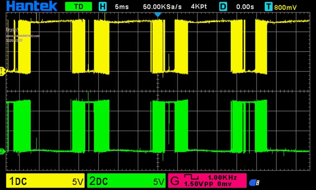

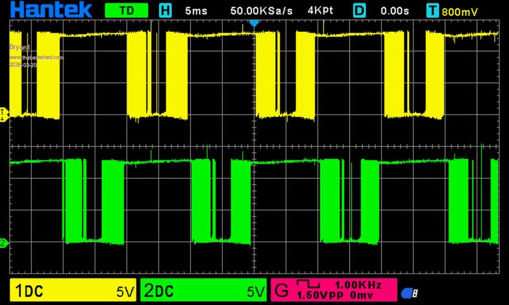

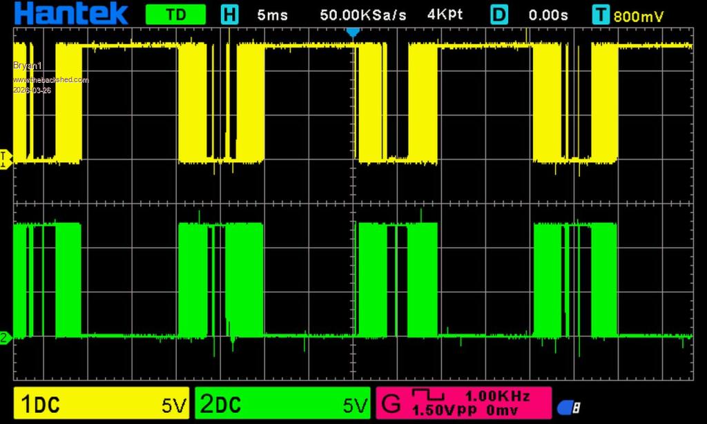

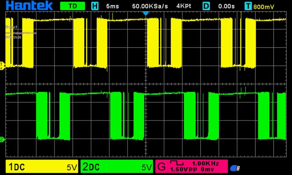

Well had a bit of break from this inverter project and got back to it this morning, replaced 2 of the TIP chip sets leaving me one spare set
Anyway got it all sorted I think
Ch1 L01
Ch2 L02
Ch1 L01
Ch2 H01
Ch1 1 L01
Ch2 H02
Ch1 L02
Ch2 H02
So after lunch time to put a NEW HY5608 mosfet on each leg for the next test.

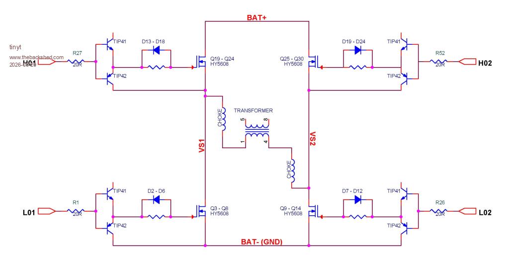

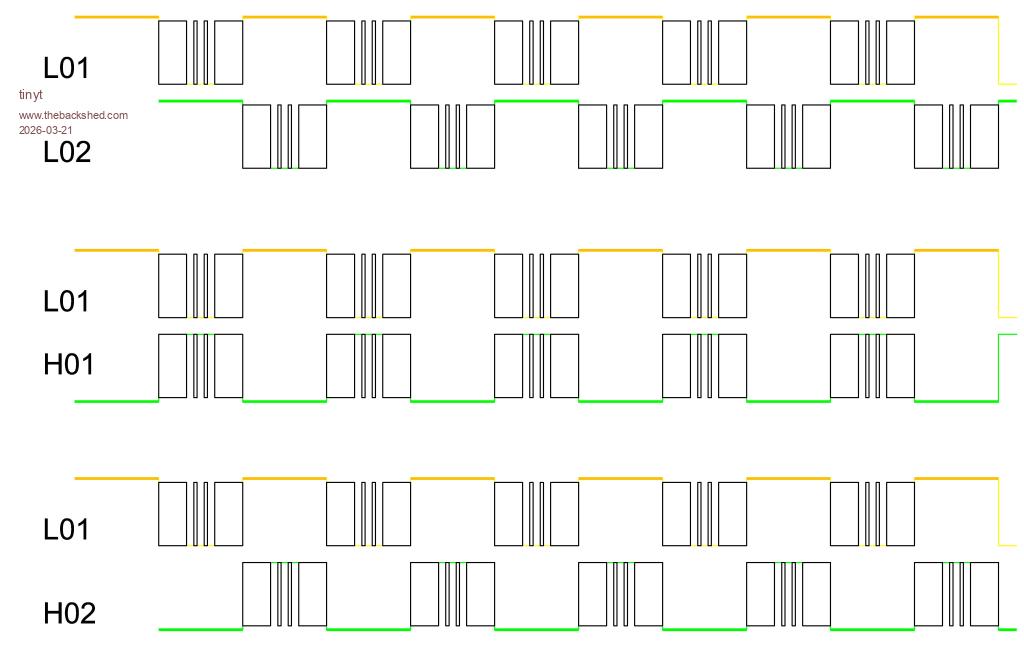

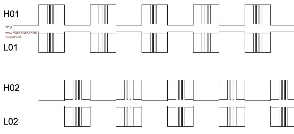

  Bryan1 said  Well put one mosfet on each leg and when I turned the control board on R52 the 20 ohm resistor started letting out that magic smoke   so replaced both 20 ohm resistors on the high side only to find it did it again.
Here is a simplified schematic of the inverter.
In your scope capture of L02, H02 both waveforms are the same.
So, Mosfets Q9 - Q14 and Q25 - Q30 conduct at the same time creating a short condition. Probably damaged the mosfets, the TIPs, and the IR2184s.
You have to make sure waveform time and voltage relationships for the signals are correct. Here is a sketch for reference, note the position of the wide lines with respect to their 0 volt.
Also, ideally, one should probe directly at the mosfet gates but a slip of the probe tip can cause damage, so it is safer to probe at the diode pins. If it shows good waveform, you know that the resistor and the TIP pair are working.
Edited 2026-03-21 00:54 by tinyt

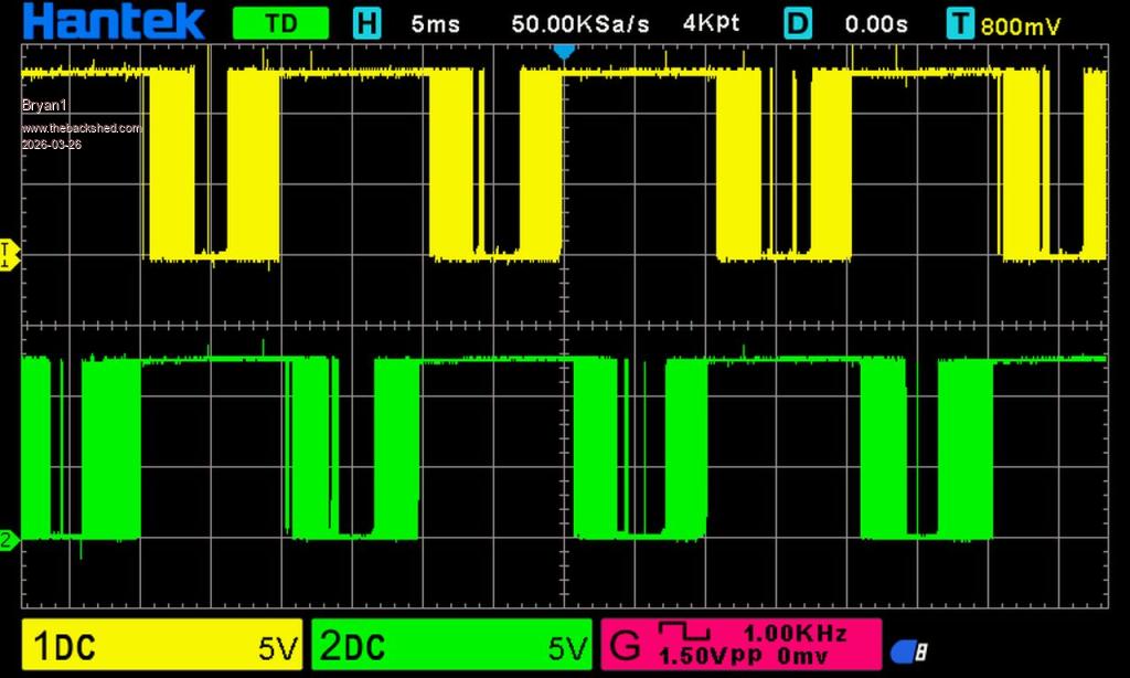

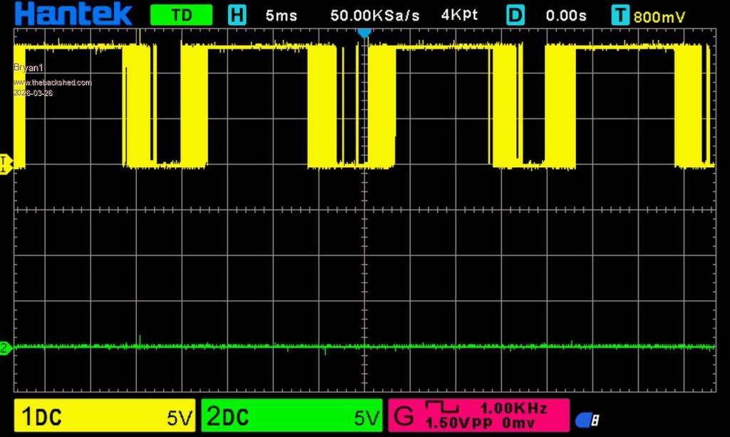

Ok getting one step closer   I put a scope probe on pin 7 of U2 and the wave form was lucky to be a volt so swapped out the IR2184 and now got a full waveform coming from pin 7 but no action at all on H02 with the scope.
Also I have confirmed the H02 pin on the 10 pin connector is in contact with R52 which was replaced this morning so I will replace the 2 caps and then try again.
Ok replaced both caps and put them in high to ensure the top solder joint was done and still no change.
So I remembered I had that 10 pin breakout cable so plugged that into the control board
Now the picture doesn't do justice to the scope but it is clear the H02 signal is going to the 10 pin connector.
I do have one pair to TIP chips so I will replace them and then thats everything replaced on the H02 side.
Edited 2026-03-26 15:20 by Bryan1

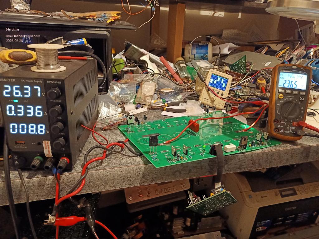

Revlac
Joined: 31/12/2016
Posts: 1309
Posted: 08:16am 29 Mar 2026

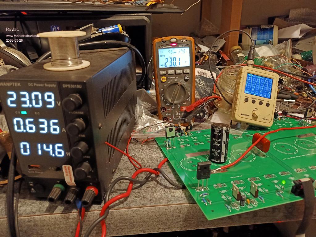

Thanks for the suggestion Peter , This is the first time I put a resister on the primary (of any build) and obviously not needed, I should have realised that earlier and removed it, I don't like blowing things up its so much extra work finding all the parts that are no good and replacing them, been there done that.
I replaced the filter cap with a 4.7uF just removed from a grid tie inverter carcass wired it in place and.............beautiful result.
No VFB connected yet, just the voltage from the Lab PSU.
Photo says it all.
Now we just need Bryans built to work.

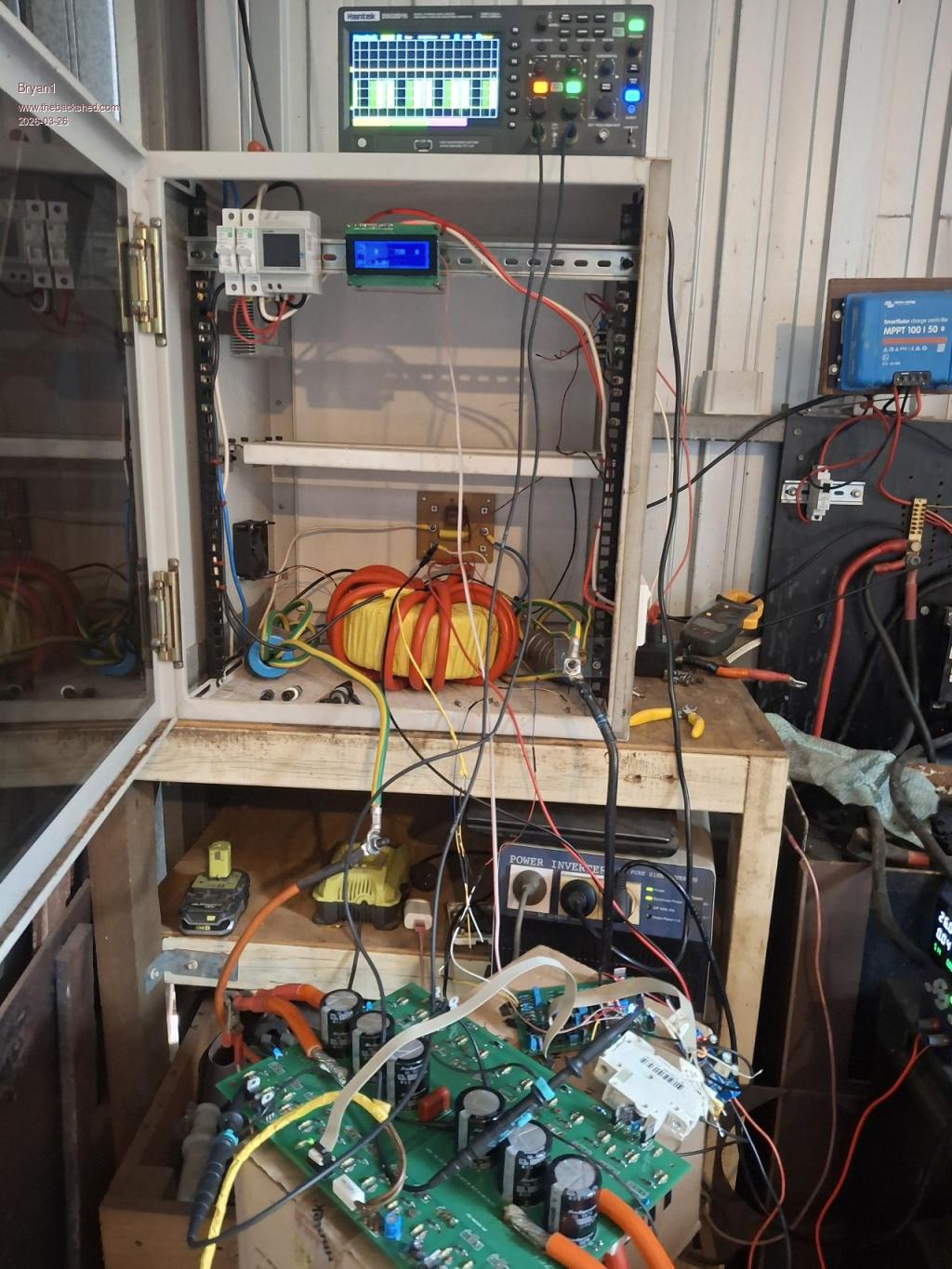

Bryan1
Joined: 22/02/2006
Posts: 2297
Posted: 02:02am 30 Mar 2026
Well had another go this morning   Confirmed the H02 pulse was correct on U2 which it was, still nothing on H02 on the board with the scope. Now D25 was on 18 volts and R52 zero volts so scratched the pad for the H02 pin on the underside of the board of the 10 pin connector and soldered in a jumper.
So after that failed replaced the TIP chips so every component has now been replaced yet still nothing on H02. The other 3 legs are all showing correct wave forms too.
Just confirmed the H02 pin on the ribbon cable is connected via check with Ohms also checked continuity along H02 and everything seems to be right so just need to sort out why the H02 signal won't go thru.
