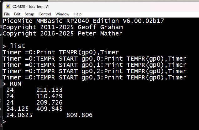

PicoMiteRP2040USBV6.00.02b16, no extra options fresh install:
No matter which pin I try, "Print TEMPR(gpXX)" always shows 1000.
This is for a single shot in console or program. If I do that in a continuous loop, I get a value every 622ms. If I do a "tempr start gpXX" the first reading will work after seconds but no further one.
normal wiring and parasitic tested
Edited 2025-03-08 08:33 by dddns

Yes, something a bit odd with TEMPR. Using 'precision' 3 appears to get it working then it is sort of ok on other 'precisions', but not quite.
> Do :Print TEMPR(gp0), TEMPR(gp1) : pause 2000 :loop
85      1000
85      1000
85      1000
> tempr start gp0 :tempr start gp1
85      18.25
85      1000
85      1000
85      1000
> Do :tempr start gp0,3 :? TEMPR(gp0), :tempr start gp1,3 :? TEMPR(gp1) :loop
19.25   18.625
19.25   18.625
19.25   18.625
19.25   18.625
> Do :tempr start gp0,0 :? TEMPR(gp0), :tempr start gp1,0 :? TEMPR(gp1) :loop
19.3125         1000
19.3125         1000
19.3125         18.5
19.3125         1000
19.3125         1000
19.3125         18.5
> Do :tempr start gp0 :? TEMPR(gp0), :tempr start gp1 :? TEMPR(gp1) :loop
19.3125         1000
19.3125         18.5
19.3125         1000
19.3125         18.5
19.25   18.6875
19.25   18.75
19.25   18.6875
19.25   18.6875
19.25   18.75
The precision requested and the precision delivered don't always match.

  Quote  Fixes bug in DS18B20/Onewire (I hope)
Perhaps it has for some DS18b20s but there appears to be more than one version. For the two I have it is a bit different to what it was but still not quite as per the manual.
One always reads 85 unless "tempr start gp6,2" or "tempr start gp6,3" are used at least once after power up.
The other always reads 1000 unless "tempr start gp6,3" precedes every read.

The only thing which works is:
do:tempr start gpXX:pause 500:? tempr(gpXX):loop
Reducing the pause leads to "1000" values.
"? tempr(gpXX)" from console does not work for me at all, neither using parasitic power wired as shown in the manual.
