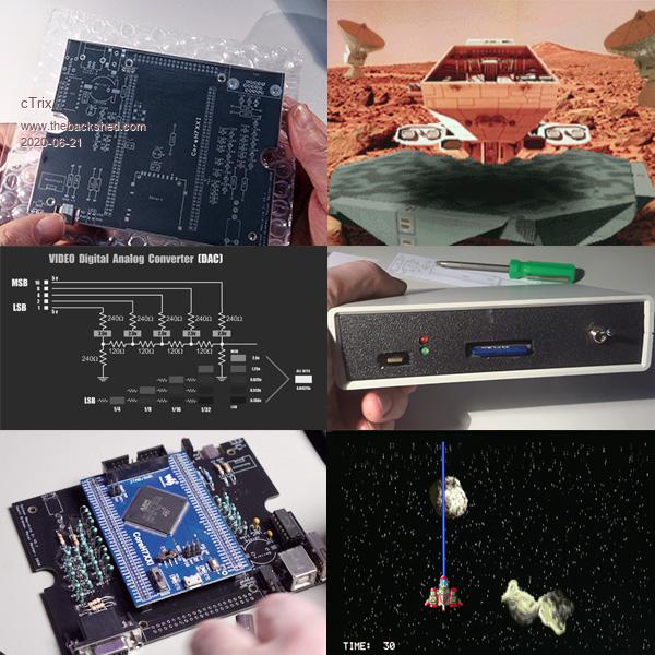

Hello all!
Finally made the video on the CMM2.  Given current world happenings, I had some shipping delays (took 5 weeks) so I didn't get a lot of testing time to make better demos.  Massive thanks to Mauro Xavier for letting me use some of his demos too.
YouTube Link : Video introducing build and demos of CMM2
Here are a few frames:
I spent way too much time on that video while I was waiting for the parts to arrive, hence all the background story - but wanted to put it in perspective for some younger viewers who might not understand what a C64 or boot-to-BASIC box actually means.  Interestingly the one sub-20yo I've shown this to instantly got it; and actually went straight for the turtle command in a loop which did some pretty awesome stuff!  So I think the CMM2 will have broad appeal; for both young and old.  The sensor compatibility and I/O to add fun player input and physical feedback also looks like a hoot.  What a platform!
Link: YouTube Colour MaxiMite 2 Intro Video   |   ctrix.net

Absolutely great video, what more can one say.

Yeah, what a fantastic introductory video for the CMM2!
Awesome work @cTrix.  Now... how do we get your video to go viral?

Many thanks!
Viral wise, we cross our fingers. (as always)  It's a matter of inspiring those who'd be interested by such a box to get excited by it.  Those who get it can't wipe the grin off their faces (like me).  I've done a bit of groundwork in notifying some key peeps so we'll see where it goes ;-)

Very great video here   , you do it like a pro !
Here we see all the heavy job done by Geoff and Peter.
  Quote  Awesome work @cTrix.  Now... how do we get your video to go viral?
Well , just share it on every social network
Congrats for the work done !
Cheers.
PS : I'm happy to see that my sprite editor is still in use with this version

Terrific video. I am of the era (Z80 alumnus), but was never a basic or games programmer or player. I am amazed, though, by the capabilities of the CMM2, and awed by those who are able to make it do its tricks.
Always hoping to see more.
