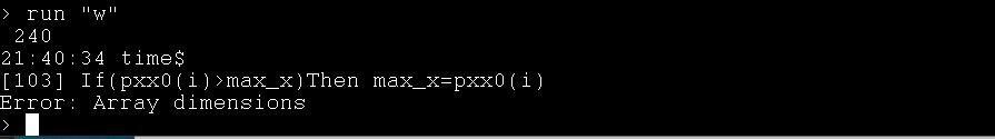

Can anyone see why this isn't working please?
It should run on any MM
It's meant to print a triangle representing the wind direction of 240deg
It's giving this result

I just cannot figure out why though
I'm using it on a pi-cromite

I think it's because you set your pxx0 (and similar variables) as integers, not arrays, so when you try to index into it (pxx0(i)), it can't because it's not an array

  Quote  It's a bug on the Pi-cromite
No it isn't. Geoff tightened up error checking and I included it. You are using declaring pxx0 as a scalar but then using it as an array. This creates the error. Fix function getlimits and it will work

  matherp said   Fix function getlimits and it will work
Function getlimits is exactly identical to the one you gave me originally (and the whole code for drawing the triangle) other than the length of the sides
I haven't changed function getlimits at all
Multiline IF ELSE was throwing errors as well, that aren't there in Stretch and the older one, which is why I tried it to see if it was me or an issue
I don't mind using Stretch, it's only a weather display after all, nothing serious

Posted: 06:28pm 24 Jul 2020
getlimits doesn't do anything useful with i so you can probably remove it and also remove all the
(i)
references.
e.g.
if(pxx0(i)>max_x)then max_x=pxx0(i)
becomes
if(pxx0>max_x)then max_x=pxx0

it works fine on Stretch, I just reinstalled the latest raspbian Pi OS, aparently PI OS  is just Buster renamed and it's definitely not working
Posts: 12085
Posted: 09:30am 25 Jul 2020
The BASIC code is WRONG. Old versions of the Picromite code work because they didn't check syntax properly. Fix the Basic code.
sub getlimits(x as integer, y as integer, w as integer, h as integer)
Local integer i,max_x=0,min_x=MM.HRES,max_y=0,min_y=MM.VRES
if(pxx1>max_x)then max_x=pxx1
if(pxx2>max_x)then max_x=pxx2
if(pxx0<min_x)then min_x=pxx0
if(pxx1<min_x)then min_x=pxx1
if(pxx2<min_x)then min_x=pxx2
if(pyy0>max_y)then max_y=pyy0
if(pyy1>max_y)then max_y=pyy1
if(pyy2>max_y)then max_y=pyy2
if(pyy0<min_y)then min_y=pyy0
if(pyy1<min_y)then min_y=pyy1
if(pyy2<min_y)then min_y=pyy2
x=min_x
y=min_y
w=max_x-min_x+2
h=max_y-min_y+2

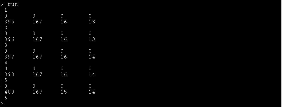

First of all, I don't have a picromite running at the moment, so I cannot test.
But from browsing your code, there seems something not logical.
You commented out the blit functions.
The preceeding ON ERROR SKIP 2 will skip the "END SUB" now.
Result: you won't see the error, but also the program may also crash.
Maybe you could also comment out the ON ERROR SKIP line.

from my "VERY" limited knowledge it seems to me from running the program that the issue "could be" that the blit read and write figures and not correct?
I thought that Blit write should have the same values as the previous Blit read??
It doesn't
the pic below shows the angle of the pointer and underneath it the values of Blit write and underneath Blit read
This was running Buster and the latest version of pi-cromite I could find V5.05.04
