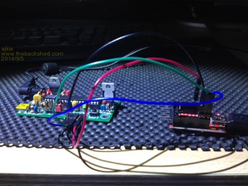

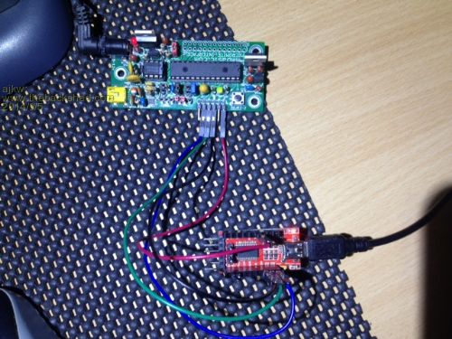

Could someone please check my set up. Programming is taking some hours to do and so far I have only successfully updated 1 PIC. Other attempts have seemingly performed successfully but I am left with a unresponsive, ie MMBasic will not boot/run, chips.
I have used Mick's MUP and Zonkers boards, Win 7 on a VM and Win XP on a laptop but all is equally the same slow.
I know John says it is slow but others like Mick have reported programming being achieved in 10's of minutes. I don't really get why there is such a large variation in time. I believe I have set up the resistor on the FT232 board correctly. Please refer attached photo's.
Even if I could get it to an hour instead of leaving it running overnight would be great.
Anthony.

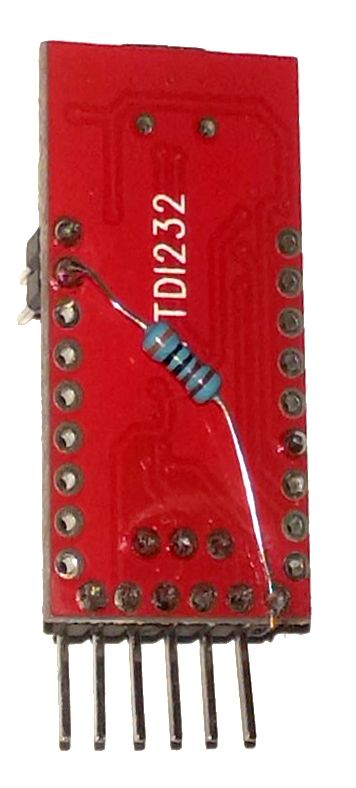

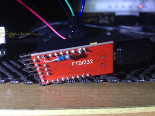

Hi Anthony,
I have my resistor soldered like this:
I checked with a multimeter and you have yours connected to effectively the same spot.
I am using the 5V on the FTDI board to power MuP.
The times I got were between 15 and 17 minutes, (I never did a `REAL' exact timing as I always missed the end)
I never had a failure on my high end PC and it was consistent, I could verify it with MPLAB IPE and it worked with TeraTerm.
It has been a while since I burnt one, is there a later version than the one I used (360,867 long)? I have been out of the loop for a while now.
The PC I have my success with is an i7 4770 with native USB3 ports, windows 8.1 64bit and takes something less than 17 minutes to complete. (it is a DELL XPS8700).
I did try an earlier version on my i7 notebook and it took over an hour and was unreliable and failed 50% of the time (sometimes at 90% mark) but that was before John added the resistor to the circuit.
The problem with trying it again is it mucks up the drivers for my FT232 drivers and on win 8.1 that can be a pain to reinstate.

Anthony,
You asked for a Linux version so I uploaded it. Is it faster?
(It is for me.)
I don't have any idea why it would run so slowly for you but maybe it points to some marginal USB thing like retries. Bad cable? Try a hub?
I've stayed away from powering via the FTDI board so as not to risk interfering with it.
Wow, you guys do resistors neatly! Mine is shoved into one end of a (du pont) wire, then poked into the side of another.
(When I went to a lower value R I poked the 2nd one into wherever it would shove.)
Seems reliable :)
I've not seen a (Linux) version take as much as an hour since I added the resistor and changed the software to use it.
