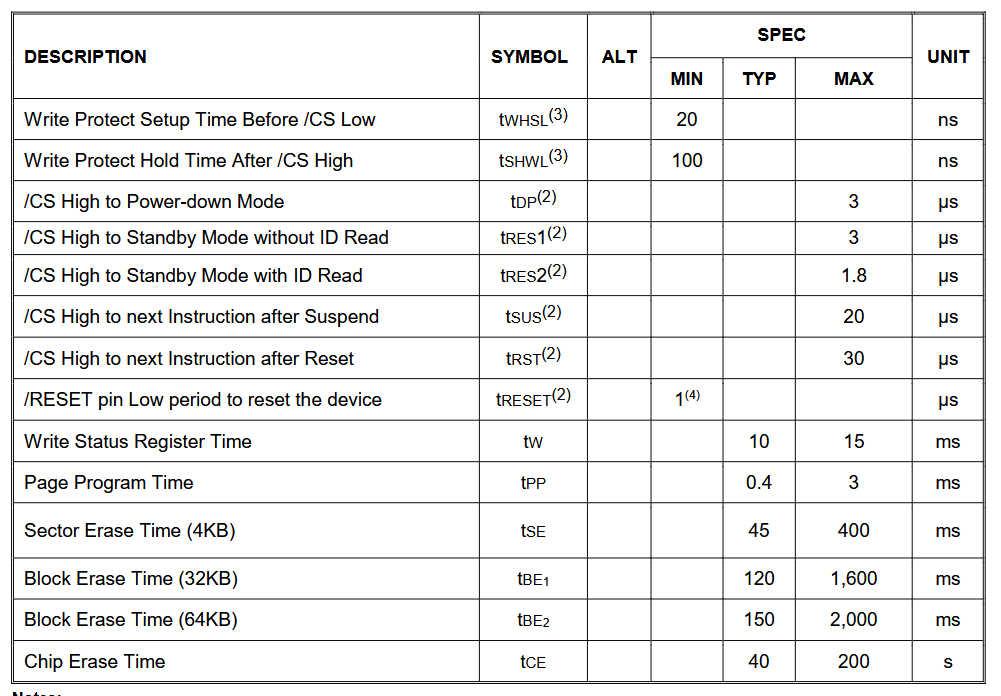

You need to think about how flash memory works. Erasing flash sets it to all ones. Writing sets the relevant bits from 1 to 0. Flash memory has a 4Kbyte page size. So to overwrite a  single zero to a one it needs to read 4K, erase the 4k, and then write the 4K back with the changed data.
Now, your use of seek, as Tom indicates, sets NULL (zero) to bytes before the new position. This means to overwrite you need to erase for every write. I suspect LittleFS isn't clever enough to compare the stored data with your write to see if it needs to erase.
See the chip timing below for more info - in particular look at the sector erase time and the page (256 bytes) write times

OK Peter, I understand, it is the erase time. I have completely underestimated this. Buffred writes are still fast, so what I've intentionally tested with constant flushing was the worst case of course. But it is good to be reminded again that writing to flash is really slow.
