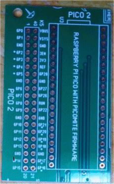

Posted: 10:43pm 31 May 2022
  Mixtel90 said  I can't imagine why not, except that I don't think VBUS and VSYS are connected to the I/O connector on that version.
With DVM set to buzz for a link, all 40 pins on PICO2 are connected to the corresponding pin on the 20x2 connector. Two-for-one PCB.
Posts: 9255
Posted: 06:09am 01 Jun 2022
Perhaps it needs some more silkscreen: "Tear along dotted line". :)
Posted: 12:10am 07 Jun 2022
Re that 20x2 breakout PCB cut from the "Pear" PCB, here it is:
And here it is in a box:
And a running example: Picomite plus 20x2 cutout PCB

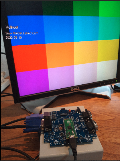

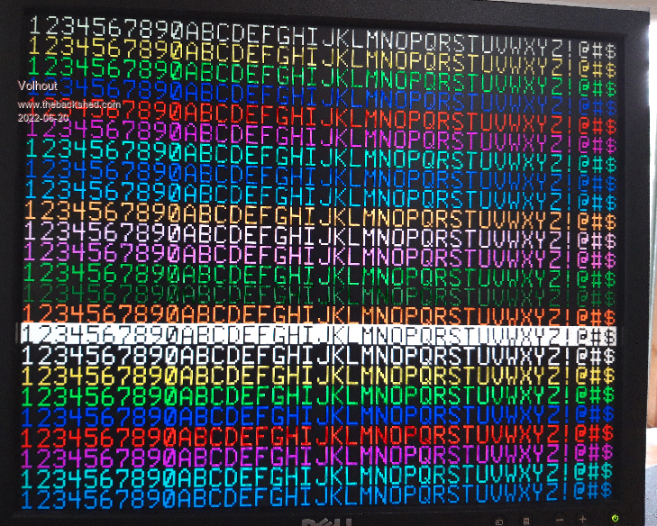

@Volhout:
I wonder if you could show a pic of what text looks like in that multi-coloured mode, please?
Is that 330 X 240?
Simplifying the VGA? I just got done copying Mick's circuit.

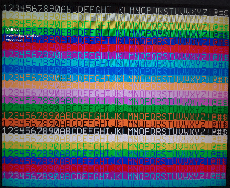

Posts: 6202
Posted: 02:34pm 19 Jun 2022
  Tinine said
@Volhout:
Is that 330 X 240?
320x240
Here are (large photo's) color text on black, and color text on color background.
I have no idea how the photos look in the forum. On the phone they look sharp.
I was afraid of that, the color on color shows some artefacts that do not show on the monitor (especially on the yellow on green).
Edited 2022-06-20 00:36 by Volhout
