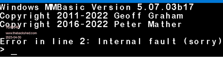

Thanks Peter, I tested it with this from your post:
a$="123456789"
? math(crc16 a$,9,&H1021)
and got this:
Posts: 12059
Posted: 10:05pm 29 Apr 2023
Here you go
MMBasic.zip
Turbo46
Joined: 24/12/2017
Posts: 1694
Posted: 10:40pm 29 Apr 2023
Thanks Peter, That worked.

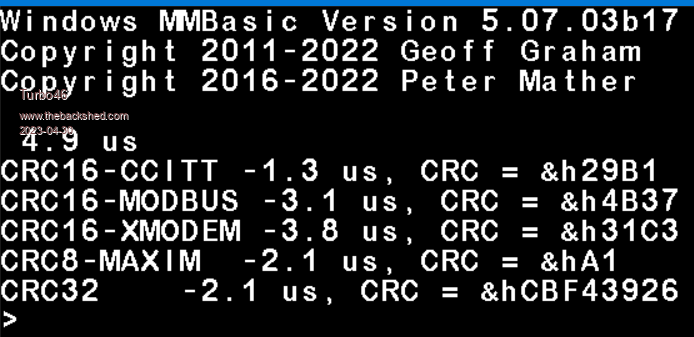

'MATH CRC evaluation
option base 1
'determine timer set/read time
timer=0
tr=timer
? tr*1000;" us"
'test string
a$="123456789"
l%=len(a$)
'convert test string to array (needed in V50706b5)
dim b%(l%)
for i=1 to l% : b%(i)=asc(mid$(a$,i,1)) : next i
'perform CRC validation
dim CRC%
'check CCITT CRC16
timer=0
CRC% = math (crc16 b%(),l%,,&hffff)
t=timer
? "CRC16-CCITT ";(t-tr)*1000;" us, CRC = &h"; hex$(CRC%)
'check MODBUS CRC16
timer=0
CRC% = math (crc16 b%(),l%,&h8005,&hffff,0,1,1)
t=timer
? "CRC16-MODBUS ";(t-tr)*1000;" us, CRC = &h"; hex$(CRC%)
'check XMODEM CRC16
timer=0
CRC% = math (crc16 b%(),l%)
t=timer
? "CRC16-XMODEM ";(t-tr)*1000;" us, CRC = &h"; hex$(CRC%)
'check MAXIM CRC8 (used in DALLAS signle wire devices)
timer=0
CRC% = math (crc8 b%(),l%,&h31,,,1,1)
t=timer
? "CRC8-MAXIM  ";(t-tr)*1000;" us, CRC = &h"; hex$(CRC%)
'check standard CRC32
timer=0
CRC% = math (crc32 b%(),l%,,&hffffffff,&hffffffff,1,1)
t=timer
? "CRC32    ";(t-tr)*1000;" us, CRC = &h"; hex$(CRC%)
Much faster though, the times are negative you must have added a flux capacitor to MMB4W.
