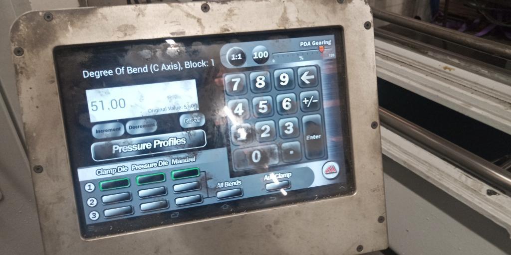

The reason that I prefer capacitive touch is that they are resilient. I have been using MicroTouch (now 3M) since the eighties and the only reason they have ever been replaced is due to a dead CRT.
This is a Samsung TAB 2 that has been abused since 2015. It responds perfectly in spite of the mess. They can't even be bothered to wipe it down.

I do like the style and color of that UI. Might be a nice exercise to port that on a pico. You would need a higher resolution screen though, 320x240 wont do. But 640x480 would. No need for framebuffers, just blit elements to screen.

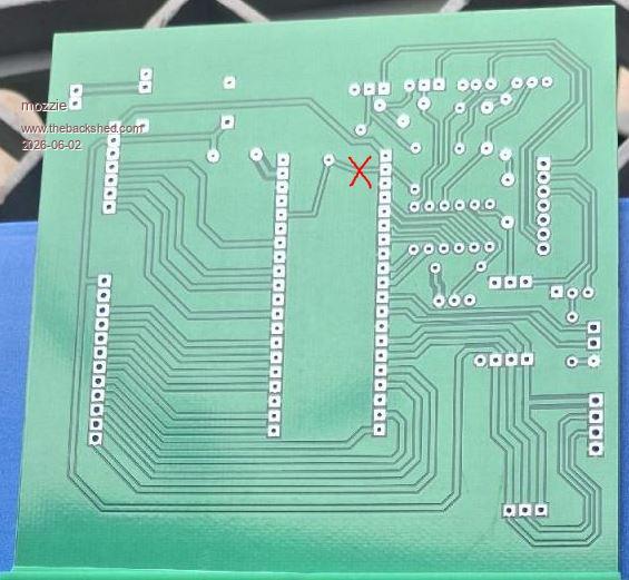

Hi Bryan,
Just looking back over some things and couldn't figure out why the steppers won't enable. This might be a problem:
I think this has the Enable permanently tied to 3v3. Hopefully an easy fix
Regards, Lyle.

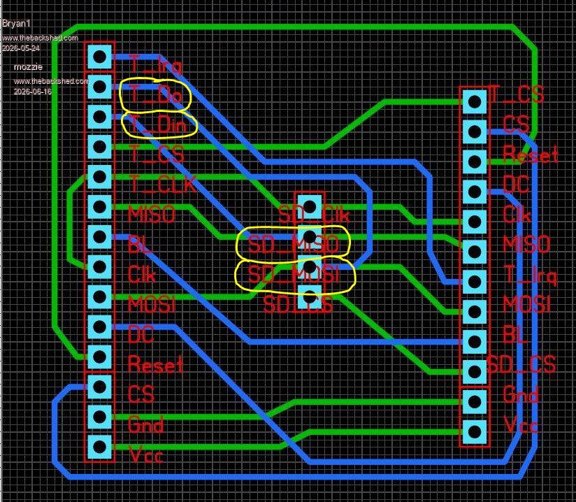

mozzie
Joined: 15/06/2020
Posts: 470
Posted: 03:07pm 15 Jun 2026
G'day Bryan,
Good to see you making progress, I have been munted by the flue (or something) for the last week, very nasty
A close look at the LCD PCB and it looks like:
MISO is connected to Touch-DIN
MOSI is connected to Touch-DOUT
This could be causing some grief
Regards, Lyle.
Bryan1
Joined: 22/02/2006
Posts: 2297
Posted: 03:22am 16 Jun 2026
Thanks for pointing out that mistake I made Lyle   I changed the SDCard 4 pin header to a 90 degree pin setup and put it under the pcb then cut both tracks and soldered in jumper wires the correct way.
I did put V3.00RC19 on and doing B: files did show the SDCard contents but trying to set the time on the RTC is still going the "not found" error.
Now as the boards only cost $3.50 for 5 of them   I'm going to get on and correct the error of the SPI lines which should make a nice no bones backpack for the LCD's.
Regards Bryan

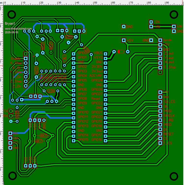

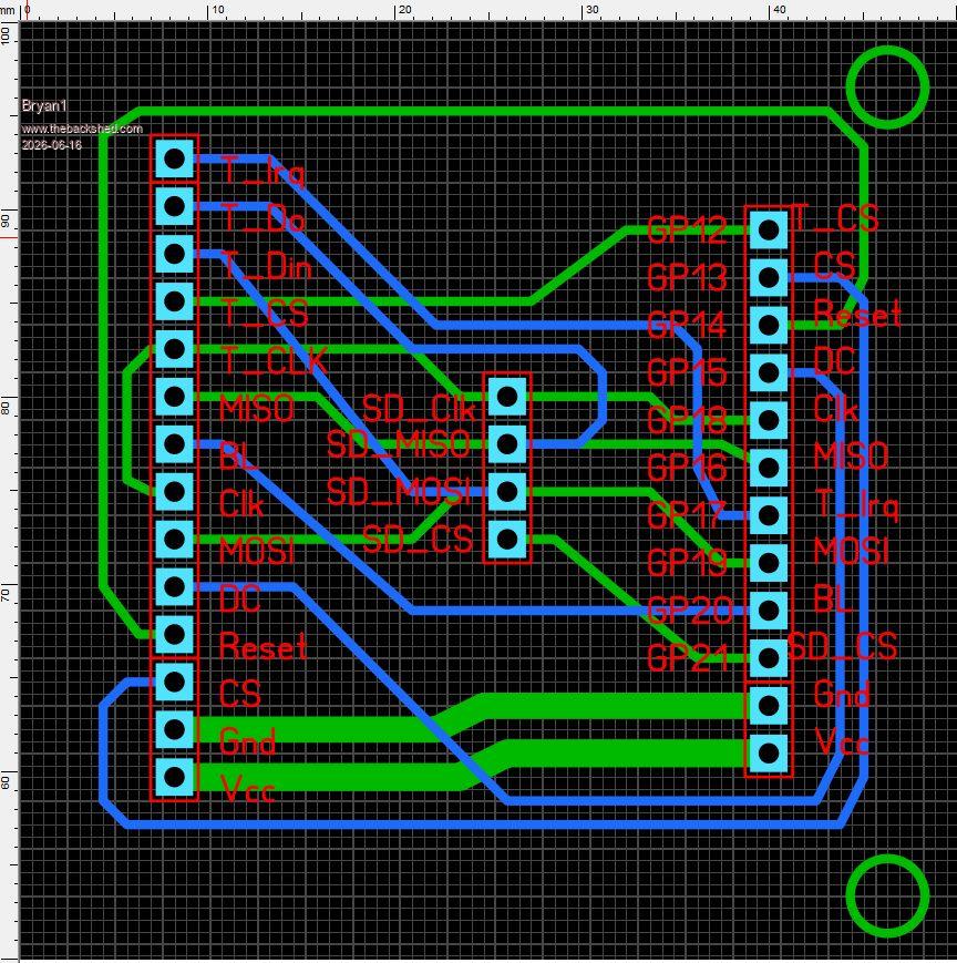

Ok it does seem these grey cells got both boards all wrong so just got on and ammended the mistakes on both boards.
Now with the LCD board moved the silk screen for the SDCard connector so one can see them and swapped over the SPI lines.
On the stepper board corrected the I2C lines, put in pullups also put GP1 which is the Enable pin to ground as tying it to Vcc stopped the steppers being armed. Also with the step and limit connectors added a non connecting pin to make them a 8 pin socket as 7 pins sockets aern't around.
Also one thing I need to do with every board which I neglected to do was put in mounting holes so they were added.
V2 Stepper Board
V2 LCD Board
Now rather than rush ahead and order these boards if I have gotten something wrong again could it be pointed out please.
Regards Bryan
