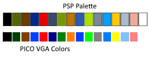

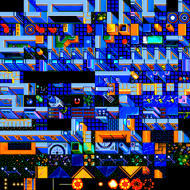

I will try the challenge of replacing non-existent colors with dithering next.
compare:
If you're unlucky you'll get a new, revised tileset
Dithering causes details to be lost, so it can only be used on larger areas.
Martin
