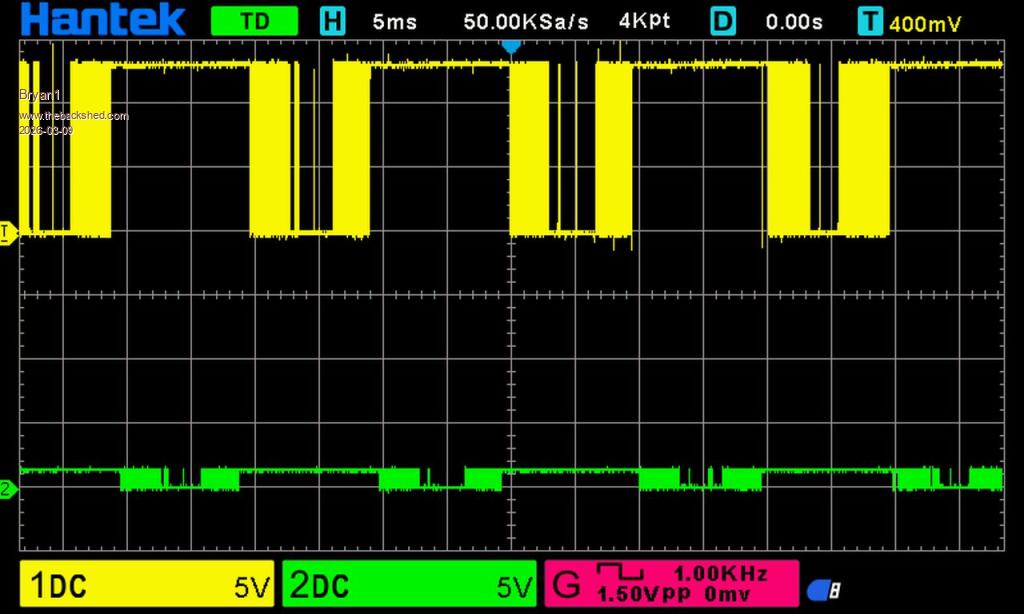

first scope test
Ch1 to D1
Ch2 to D7
Gnd

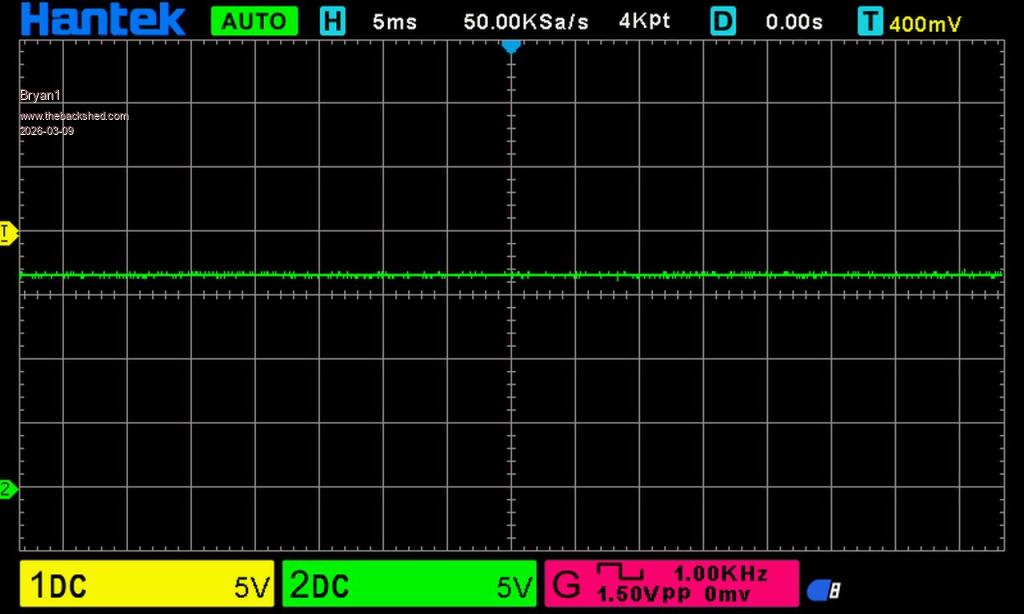

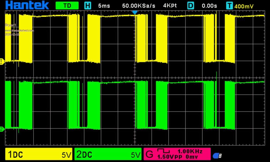

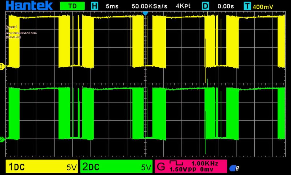

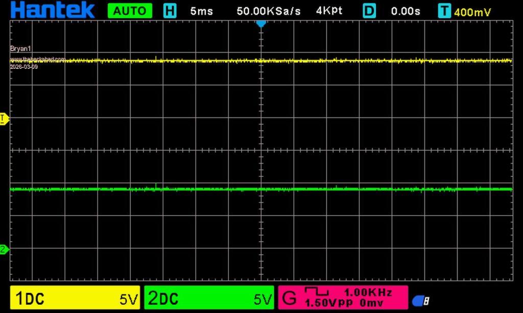

VS1 Low side
CH 1 pin 1 on the TIP42
CH 2 pin 1 in the TIP41
VS 2 low side same setup
more to come
VS1 high side
VS 2 high side
So it does look like the high side TIP's are gone.

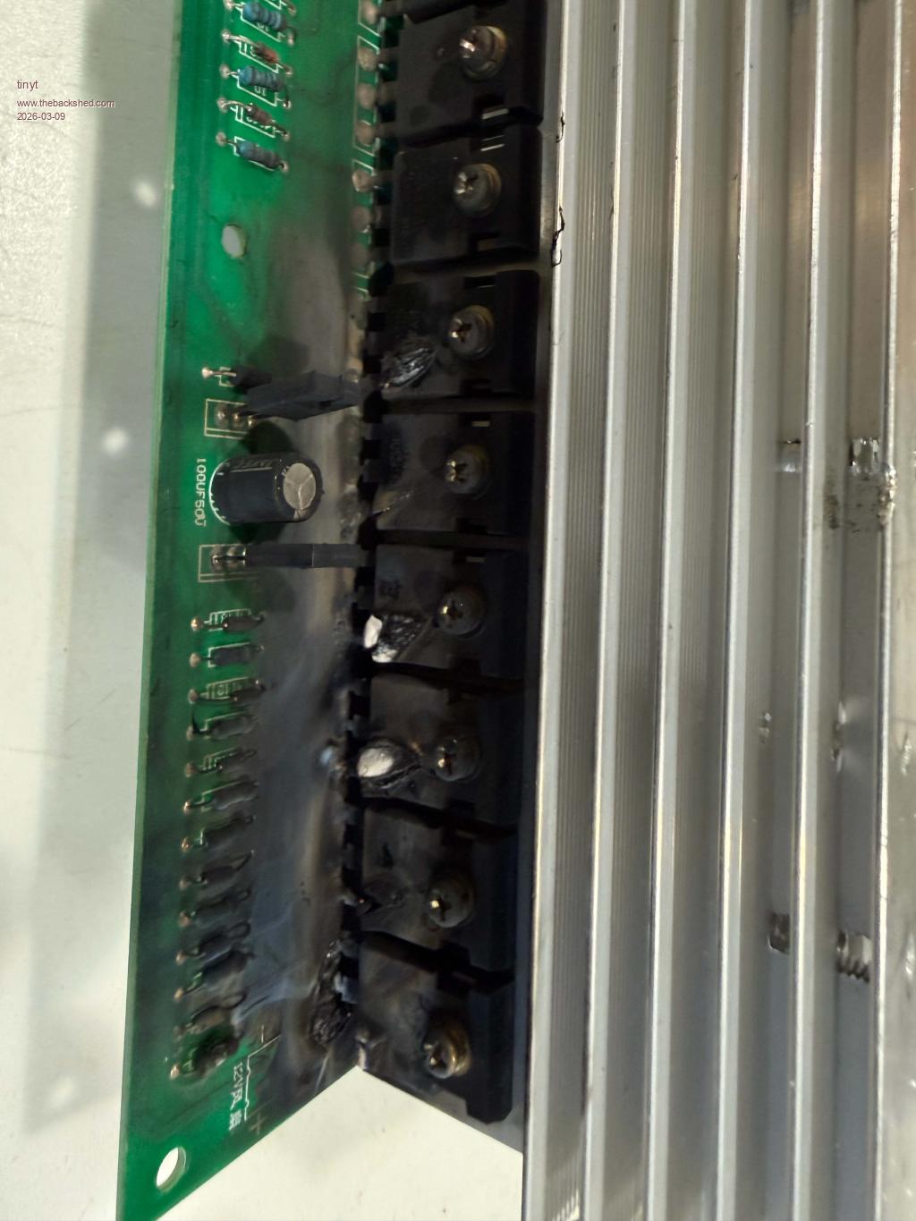

Now when I was testing yesterday and found the high side TIPS weren't showing anything I did measure some voltages. Those fast diodes were showing 17 volts and the TIP31 was 17.7 VBat 17 volts with the 18V zener on 17.7 volts
It was a bit of fun unsoldering all those mosfets and on 2 legs I did lose the track from the track to the 4R7 resistor. Well with 6 mosfets for each leg and just leave that those 2 blank mosfet pads.
As I am using HY5608 mosfets 4 of them should be plenty
Posts: 3416
Posted: 09:44pm 09 Mar 2026
The track to the 4R7 resistor can easily be replaced with thin wire curled around and soldered to the leg at each end of the missing track.
