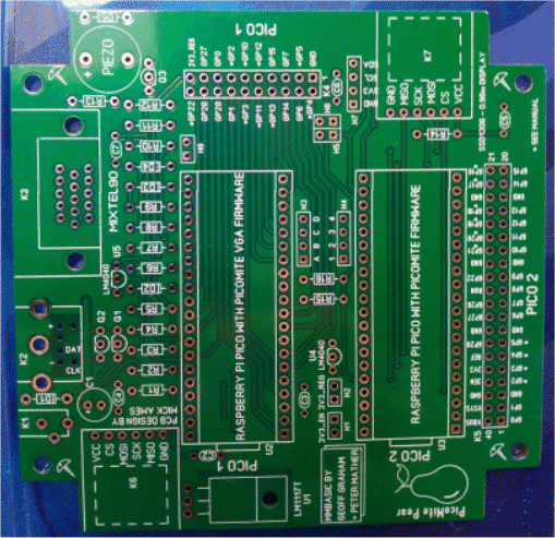

Posted: 02:38pm 31 May 2022
  Mixtel90 said  ... Phil has suggested using a simple resistor pair instead of the R-2R ladder for green, but I've not implemented it. ... I also used it on the PicoMite Pear, but no-one has even considered building that yet. :)  (I've not posted the latest gerbers for that yet.)
Just received my "pear" pcb from JLC. Anything particular I should be aware of?
Posts: 9256
Posted: 02:52pm 31 May 2022
Ah - that seems to be the first one to be built. :)
I don't think so. I did the usual tests in Sprint Layout and didn't spot anything obvious.
Looks like a nice board.
If you use 90 degree connectors for the GP ports then the PICO1 connector is flush with the edge of the board, the one for PICO2 projects out through the front panel of a Hammond box.
The SDcard socket for PICO2 will probably have to be soldered to the board without a socket if you are going to use the LCD display, otherwise I think it will obstruct it.

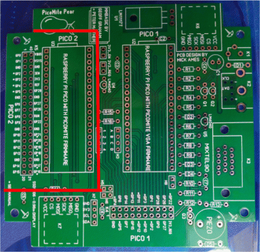

Posted: 04:37pm 31 May 2022
Thanks. While I'm gathering parts for the pear pair, I need an as small as possible picomite PCB breakout. Since I have 5 of these pear PCBs and don't expect to need more than one, is there any reason I can't just cut out the PICO2 along the lines shown in red below, and use the 20x2 connector, powering either through USB or VSYS?
