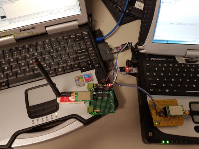

Posted: 01:52pm 14 Sep 2017
Here is a snap of the hardware test set up I have. There may be something extremely obvious that I have missed.

  Quote  Assume you have M0 and M1 grounded?
Yes Dave I have links to ground on the left unit and DIP Switches on the right unit as belts and braces I have included 10k pullups. I have a LED on the AUX pins and this does indicate when data is transmitted from either unit but I do not get a response when receiving.

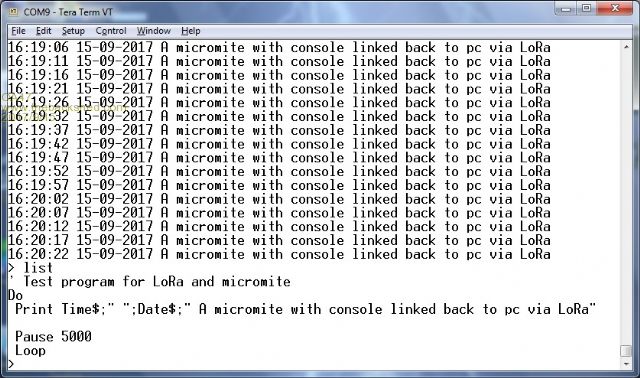

Posts: 1056
Posted: 08:33pm 14 Sep 2017
  Quote  C'mon, Graeme, you code-tease - tell us what you did to make the link work and what you were doing wrong
I will fess up. I had confused one of the bus tracks on the arduino prototype board and the LoRa module would not be able to stay in mode 0. I should have twigged earlier as the unit on the Freetronics prototype board would sometimes go into config mode without switching the M0 & M1 leads.
Any way this is a start:
I am not sure that editing a program at this data rate will be successful but I will have a play with different settings to see if I can get a more usable system.

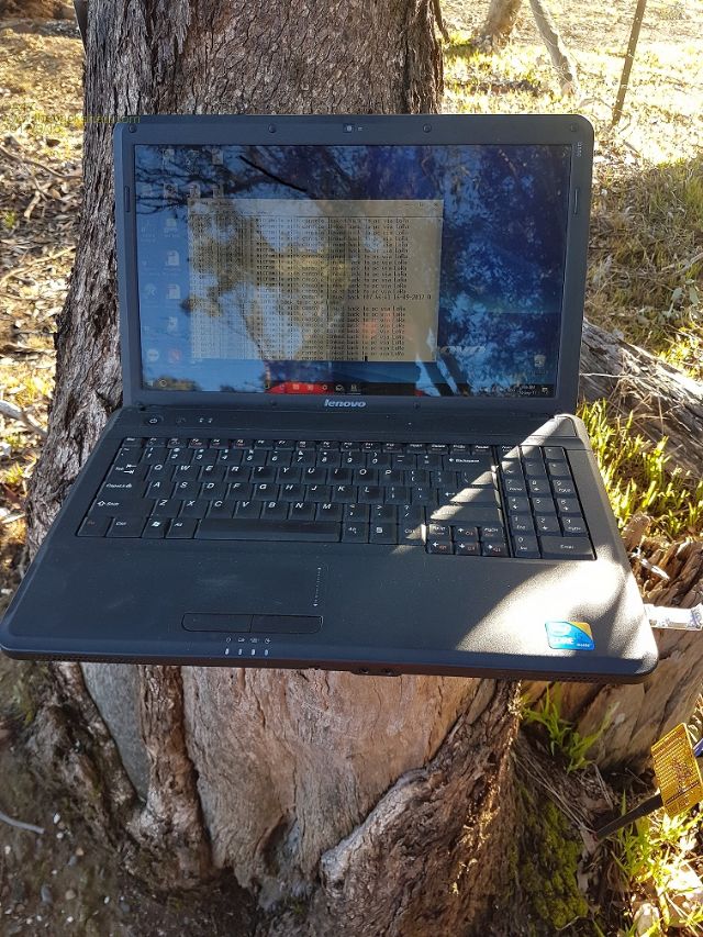

Posted: 12:03pm 15 Sep 2017
  Quote   I'll be interested to hear back from you as to what range you actually get from them while I wait for my ones to arrive.
Grogs, I did a very scientific range test. With the units set at 10dB power and the transmitting unit on a test bench in the steel clad back shed, I went for a walk to the back gate which is over a hill and about 150 meters from the shed. As the photo shows there were some dropouts but software could distinguish them.
