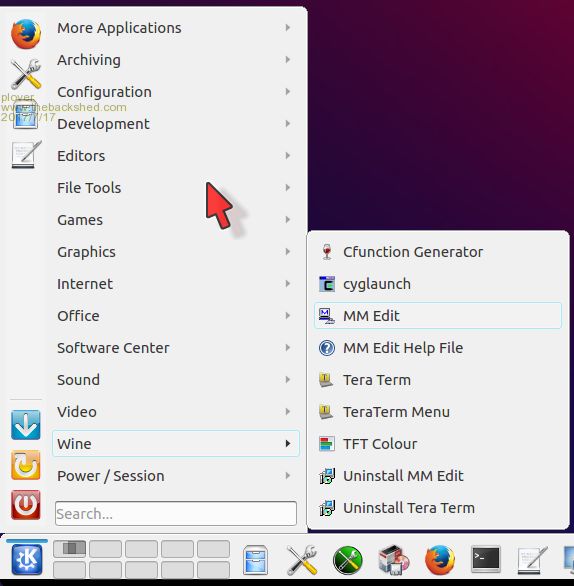

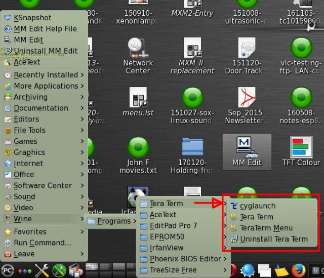

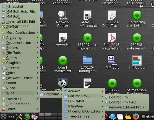

I will explain what I meant by "disappeared out of the K-menu entry". I deleted MMedit in the CCom folder, ie just deleted the folder CCom, that was my way of uninstalling. MMedit was not installed by "wine control" so this could not be used to uninstall.
  Quote  /home/gert/.wine/drive_c/Program Files (x86)/CCom
After deleting I the used "wine control" to install MMedit again, to my surprise this just created the same CCom folder. I was expecting to see an entry under K-menu (PC-menu) wine entries as shown in the picture:
I know there are a few options in the CCom folder, for example the CF-gen option and uninstall.
Some installs earlier did show MMedit in the PC-menu wine listings, with options but I don't remember exactly how many and I don't know at what stage MMedit dropped out from the PC-menu wine location.

You are helping more than you think. I am very intrigued, and curious because something is not behaving as I would expect. I don't believe it is MMedit that is the problem.
When I connect with Minicom 2.7 or gtkterm, while they are not much good to do more than just confirm connection, both do not behave as I expected from previous experience.

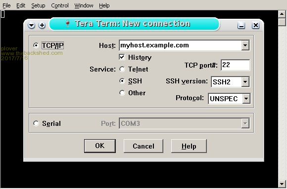

Well I have downloaded TeraTerm 4.88 and installed it under Wine ver 1.8 using the "wine control" (I do cheat when in hurry and just do "wine <whatever .exe file>" seems to work fine. "Wine control" looks like a GUI interface and allows install/uninstall via this graphics window. I did this for Tera Term, and now has the following in wine menu:
If you have any idea why MMedit does not make an entry like that (as I said earlier I have seen it do that on an earlier version and I think too on the latest. Of course I can no longer recall well the details at the time) The only thing I can think of is the extra tick for memory patch, could that be it.
That aside, when installing TT and getting used to how it operates, I have not yet been able to make a connection to the Mup-ver2 but what I did notice is that TT seems to have TCPIP option:
Looks interesting but I do have a problem, don' know what I need to fill in.

I also installed with "wine control" two programs, MMedit and Tera Term, at the moment it is 1 score to MMedit 0 score to TT, so far it appears that TeraTerm will not offer more than COM1 and COM2 so no luck getting TT to work.
This new KDE5 install has a poor Wine-menu unfortunately so I have more work trying to sort this out
Very faint you can see "wine" been selected and in second list MMedit has been selected waiting for the click. The disappointing thing both the TT and MMedit options are lumped together. This must be wine or KDE problem.
What I have proved is that MMedit does install into Wine-menu on the new system (I first installed without memory patch, would not run on the new system. Checked the Wine-menu was as shown and then I just re-installed on top of the existing system with memory patch option and it works fine)
I got immediate contact with Mup-v2 when I selected COM4, next Maximite test on the KDE 5 system (PCLinuxOS)

To get TeraTerm to find the serial ports you might have to edit the Wine registry.
https://onetransistor.blogspot.com.au/2015/12/wine-serial-port-linux.html
I don't have enough room on my Linux installation to install Wine but I might sacrifice an old laptop.

It is now 2 points to MMedit and still nil points to TT. Had trouble getting MME to re-connect to the maximite, in the end I removed all wine COM links and created just COM2 and made sure this worked with Mup-v2 (ttyUSB0 linked)
Then I created COM1 and got it to work with Maximite (ttyACM0) so now I am just about to go back to my KDE64 which is my battered work system, to see if I can get MMedit install "properly" and see if I can make connections. Then I will get back to TT, TCP/IP option looks interesting but who is the host, I am used to work in IP numbers and the micros do not have IP or perhaps they are not hosts?
Will check up the link, some hours ago I pondered if it really was necessary to get into registry work. Never felt comfortable with that database.

I had a connection to Tera Term on ttyUSB0, that was a total disaster. I got the prompt from the Mup-v2 and I was connected in a fashion but very slow. The mouse stopped working well it was delayed many seconds so I gave up.
Forgot to close down TT and of cause when I connected MME again and eventually found out that it now needed linking to ttyUSB1 (at which time I had shut down TT so ttyUSB0 did not show in the /dev/ directory.
Ok, I think I can just about handle the connection in wine, MME clear winner. I will write down exact details which works for me. Doing it here will leave me a record I will remember for some weeks so when I go wrong next time it should be easier.
Funny if I can get TT connected and get a such a poor result I must have something terribly wrong.Edited by plover 2017-07-18
