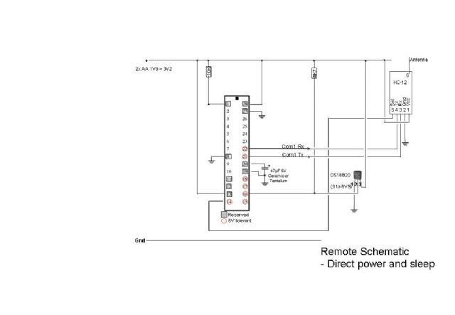

I believe that the above code puts it to sleep - in the end it wasn't too hard, even for me (my code above seems to work). If you use the last dozen lines of code, commented out above, it certainly reports "OK+Sleep". I have achieved twice the battery life (and still going).
But, using my historic DMM I could only detect that the sleep current was less; but could not get a repeatable reading - if you look a few posts above HankR reports that the sleep current is not steady but is actually a series of pulses which average to the values given in the specs (hence my confused DMM).
My remote schematic is:
Cheers, Andrew
HankR
Joined: 02/01/2015
Posts: 209
Posted: 11:17pm 20 Sep 2017
  Andrew_G said   My 2x AA-powered remote (an MM170, a DS18B20 and an HC-12) is still working after 4 weeks but the battery voltage has dropped from 3.2V to 2.93V.
It can't keep going much longer!
I've set the HC-12 to FU-2 mode at 2400 baud and have included all the above power saving suggestions (except a 3rd AA battery which I can't fit in this jiffy box).
A month's life is OK but are there any more suggestions?
Andrew,
I have one basic recommendation and a comment or two. It's going to be about circuit considerations rather than software from now on.
You're using too high an endpoint voltage for the life of the device and its battery.
When I provided a battery life estimate it was based on a much lower endpoint voltage. I thought you'd be implementing the third AA cell as suggested before.
I think you really have to not let the present box size dictate an unrealistic and ineffective design as you now have. You pretty much have to increase the voltage of the battery to something like a minimum of 4.5 volts. Adding the popular MC1703 regulator will use an insignificant (compared to the high Micromite sleep current) quiescent drain of around 1 uA.
Now you can tolerate some realistic droop of the battery and still have the device running okay, both the uC and the transmitter components. The uC can go way under 3 volts, but the HC-12 can't, therefore the 3 volt supply has to go. Out!
The droop of the two AA cells still seems too high, although much better from where you started a while back with a 2 day total life!
As I've asked you to do before, it's really necessary for you now to get some steady current readings and these you can do with your DMM. I would like you to measure the sleep current of the MMite and the running current of the MMite. The sleep current is the more important reading, but you might as well do both while you're at it.
This is not as critical but if you added just a little test code, you could have the circuit report to you over the serial port the time the whole awake cycle takes in milliseconds. Same for the HC-12 activation and sleep subcycle. Again, these are second order importance measurements, but nice to have at this point in the development cycle.
I might have to finally get a MMite so I could do some of these measurements, because there is still something not right going on.
It's good, but it should be a few more months I believe for that kind of voltage droop to manifest.
Oh, one question. Were those fresh AA name brand cells? I would guess they were based on the 3.2 start voltage.
Hank

Andrew's design is really very good. The only area left to be refined is the average current is higher than he'd like and higher than I think can be attained with his basic present circuit allowing for perhaps a tweak or two.
My intent always is to use the numbers, along with the basic principles, to illuminate the mechanisms at play whatever aspect of a circuit is being explored.
The very practical value of knowing the principles is to be able to most effectively put one's time and effort into only those methods that will gain worthwhile circuit improvement. And to do the best methods first, and then the lesser methods later until one is satisfied with the circuit's performance.
Another great value is knowing when, practically speaking, the law of diminishing returns is kicking in and all the reasonably worthwhile improvements have been made and the designer has reached the limits essentially of what can be accomplished with the constraints imposed. There are always some constraints, even in the hobbyist domain: cost, weight, size, cost, input power, etc.
So it's basically informed experimentation and is applicable to the hobbyist.
Hank

Andrew_G
Joined: 18/10/2016
Posts: 910
Posted: 12:22pm 21 Sep 2017
Hi all,
Thanks for your interest and help. I'll take the measurements that Hank suggests (it will take a few days) and I’ll use a breadboard to build another circuit with:
- easy access to measure currents
- 3x AA batteries (with voltage regulator to 3.3V)
- a transistor to sever the power to the rest of the circuit during sleep (I’ll be interested if the start-up current balances out the savings? - any comments anyone?)
- I can easily reduce the CPU speed to 5 whilst the MM is asleep
- I can change the reporting frequency from once every 10 minutes to say 15, 20 or 30
(I take Hank's comment about the point of diminishing returns but these seem easy and viable)
I'll shortly start a thread to illustrate what I do with the data.
