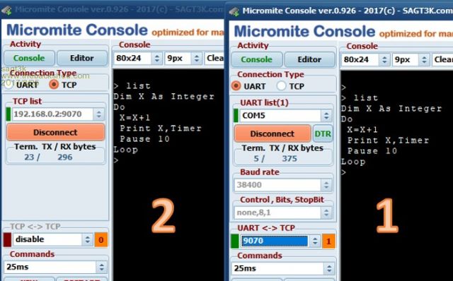

- Concerning the file .cfg, You do not have to handle or edit the file.cfg . All configuratios reflect settings at program closing.
- MicromiteCons is a portable software, than you need permission on directory where reside file.exe.
- [TCPlist] is populated when you type an IPaddress:Port. When press Connect, this IPaddress is added in the list. To remove it from the list, select and press CTRL+DEL.
- Short Command as the same function of TCPlist. You can digit complex instruction and press SEND. To remove it from list,select and press CTRL+DEL.
Here you can download vers. 0.927 new version.
+ Improved TCP Client/Server management and fixed a few of bugs.
Here is an example, two connections, one with an UART with TCPserver enabled on port:9070. The other as a TCP client connected on 192.168.0.2:9070

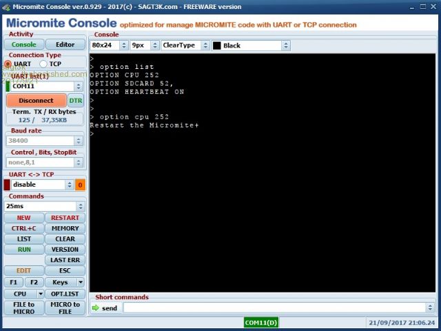

Hi to Everybody
New version 0.929 of Micromite Console:
+ some display issues solved when is connected with TCP/port
+ added CPU frequencies for MMX
+ added button Keys (F3,Shift-F3,F4,F5)
download v.0929
report VirusTotal PASSED
Antonio

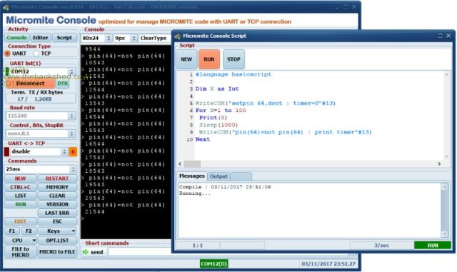

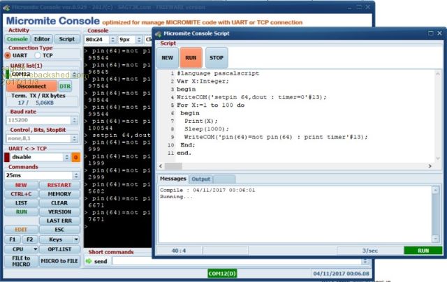

Hi to Everybody
I announce that I will soon release a new version with a new feature, I've integrated a script engine, now with 2 languages "Basic" and "Pascal".
You can create scripts that can interact with the open console, as an example to write or read the UART or the console via TCP. This allows you to create datalogs, report views, data exchange, etc.
If anyone is interested in something that I can implement, let me know.
Antonio

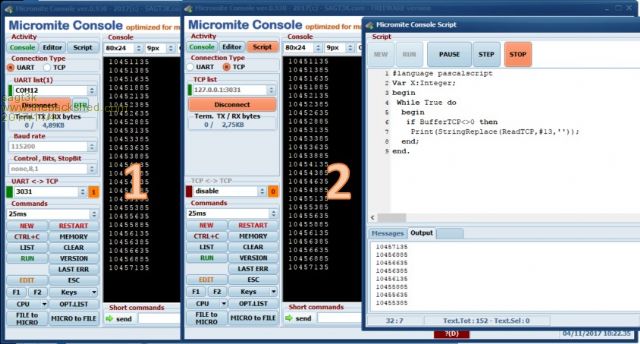

In this example, there are 2 sessions of MicromiteConsole.
1) The first is connected to the COM(12) port with a Micromite64 and put in the TCP/server port 3031 the serial, such as ser2net.
2) In the second session of "MicromiteConsole" a connection to the TCP/3031 port is active and in addition, a script that reads the TCP buffer and prints on the output of the script module.

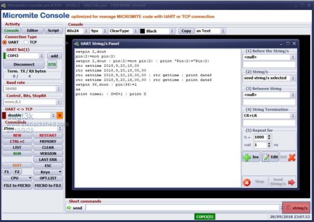

Hi to Everybody
I announce a new version with a new feature:
- add string panel to send strings with different functions,
send special hex/chrs or sequences, before, between or termination when sent single or multiple strings.
- the button "string/s" is enabled when a COM is activated
Here the link for download v.09.34
Every comment and / or suggestion is appreciated
