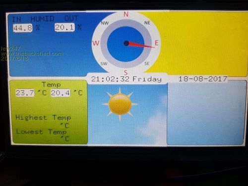

Thanks Gerry, the flicker is greatly reduced
However I'#m still getting the static needle (as well as the moving needle) at the 12 o'clock position after the needle has completed one complete rotation
the relevant section of code is (the only bit I removed is the get time bit to display the time)
[code]getlimits(x, y, w, h)
blit read #1, x, y, w, h
'**********************Start of Main Program**********************************
'Direction pointer test
for bb = 1 to 360 'so I can see the pointer move one complete revolution
pause 10 'delay of 10mS so I can see the pointer steps
heading = heading+1 'increment the heading 1 degree clockwise
drawpointer(heading) 'draw the pointer
print bb 'so I can see how many times the pointer moves before it crashes
next bb
'End of direction pointer test
LOOP
End[/code]

disco4now
Joined: 18/12/2014
Posts: 1159
Posted: 02:24am 17 Aug 2017
Hi Lewis,
Not sure why yours does not work. Here is basically your code that seems to work for me. See what it does for you.

lew247
Joined: 23/12/2015
Posts: 1709
Posted: 10:53am 17 Aug 2017
Hmm
I honestly don't know why it's not doing the same on mine
When it gets to the the end of the FOR NEXT loop and restarts the loop the pointer stays on the screen at the 12 o'clock position
I've enclosed my full code here. you might need to comment out the displaypicture lines and temp and humidity

disco4now
Joined: 18/12/2014
Posts: 1159
Posted: 03:39pm 17 Aug 2017
Hi Lewis,
The problem is that Global variable y is being used to remember where the background is stored and also in the DayOfWeek function. Everytime DayOfWeek() is used it will upset its memory of where the blit command put the data.
Add this line to make the variables in the DayOfweek() local
LOCAL INTEGER a,m,y
Function DayOfWeek(year AS INTEGER, month AS INTEGER, day AS INTEGER) AS INTEGER 'Day of Week Function
local integer a,m,y
a = Int((14-month)/12)
m = month + 12*a - 2
y = year - a
DayOfWeek = (day + y + Int(y/4)-Int(y/100)+Int(y/400)+Int(31*m/12)) Mod 7
End Function
A tricky one,
Gerry
F4 H7FotSF4xGT
lew247
Joined: 23/12/2015
Posts: 1709
Posted: 08:14pm 17 Aug 2017
Gerry that's perfect thank you so much.

lew247
Joined: 23/12/2015
Posts: 1709
Posted: 10:34am 18 Aug 2017
It's a 7 inch TFT
Can't see why it wouldn't work as far as I know they are identical other than the screen size
Edited by lew247 2017-08-19
lew247
Joined: 23/12/2015
Posts: 1709
Posted: 10:45am 18 Aug 2017
Gerry can you try the following code instead of the "test rotate FOR/NEXT loop" please?
[code]Heading = 100 'MAKE THE HEADING 100°
drawpointer(heading)[/code]
With any value OTHER THAN NEAR 180 (pointing South) the needle is nice and stable
With the heading=180 or anywhere near it then the "point bit" of the needle dissapears
any ideas?
Posted: 10:49am 18 Aug 2017
Lewis,
You have a lot of TEXT commands; some clearing the relevant 'area', and some displaying data. It is likely to be a TEXT statement that is just 'over' the area of the tip of the pointer.
What are the co-ordinates of the centre of the pointer; and also the radius (in terms of pixels). I will then look for a 'suspect' TEXT that might be the cause. Then simply comment out the TEXT statements that are close to the dial.

lew247
Joined: 23/12/2015
Posts: 1709
Posted: 11:00am 18 Aug 2017
WW it makes perfect sense, that was my thought also which is why I moved the "time readout" down to the bottom of the screen to test if that was the problem
it's directly under the 6pm position - but it made no difference
The pointer is 94 pixels long and the center of it I'm not certain
The fulcrum is circle 397,110
[quote]relevent section of code[/quote]
dim integer ptr(5)=(-7,0, 7,0, 0,-94) ' define size of the pointers
sub drawpivot(offset as integer) 'put anything you like here to draw the fulcrum as you wish
circle 397,110,pivot,0,,,rgb(54,54,54)
end sub
I'm also slowly getting rid of the text on the screen and trying to figure out how to use numberbox to display the values for the weather displays
