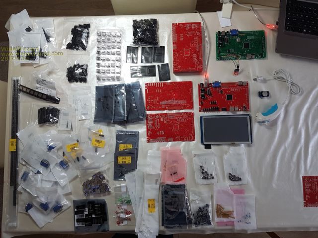

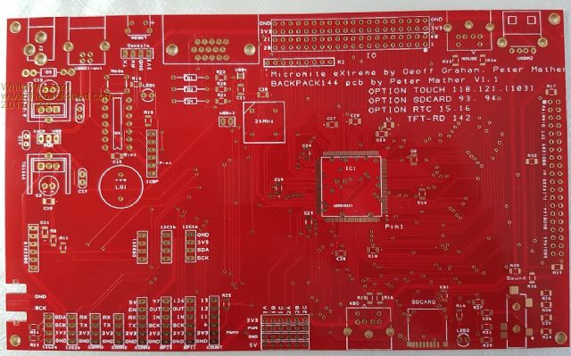

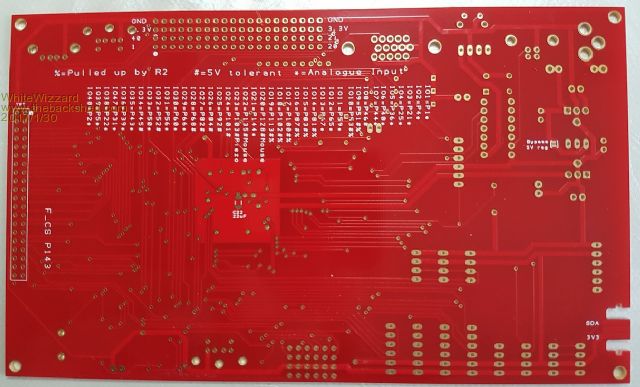

First pictures of MMX144 PCB
PCB is finished in Gold (makes for easier soldering; as well as looking very nice!) with a red solder mask.
Underside shows the 40-way GPIO pinout to the MMX (and the solitary 22uF capacitor!!)
A couple of silkscreen teething errors have already been fixed by Peter (Thanks Peter )
More photos top follow shortly . . . .

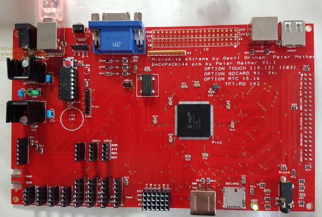

The first one has just been assembled this morning . . . (still need to tidy some SMD joints on all the decoupling caps)
I ordered the incorrect onboard piezo so it is unpopulated in the photo
Notice the 'HeartBeat' LED on the lower edge (honestly - it is flashing which means the module is 'alive')
Now to connect a console/PC . . .

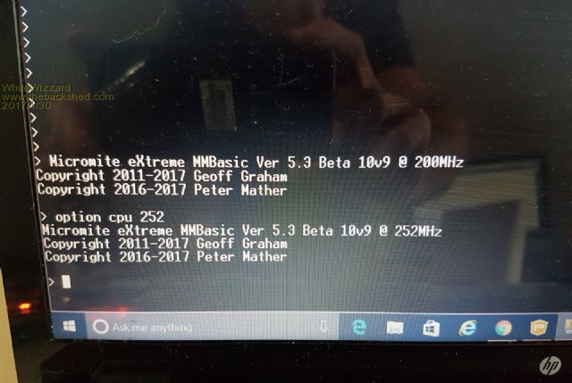

Posted: 01:39am 30 Jan 2017
As with all Geoff's 'inventions' (and Peter's code), it just works first time . . . .
.... running at 252MHz
Posted: 01:47am 30 Jan 2017
Now where do I begin
The assembled green PCB in the picture is the original prototype (no mouse connector, no Nunchuck connector, no buzzer)
I still have to test the completed PCB (VGA, SSD, SD, I/Os, RTC . . . ).This will take some time so I will not ship any pre-orders just yet. I will keep you all updated on this thread with progress . . . .
