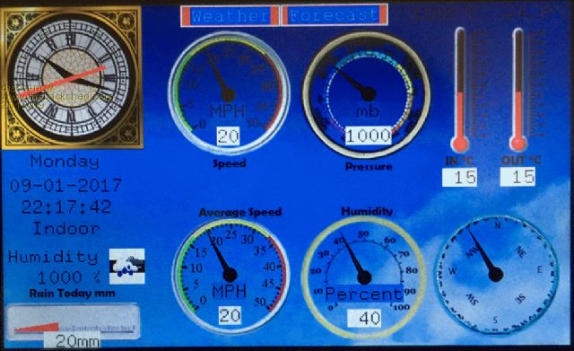

Posted: 02:17am 09 Jan 2017

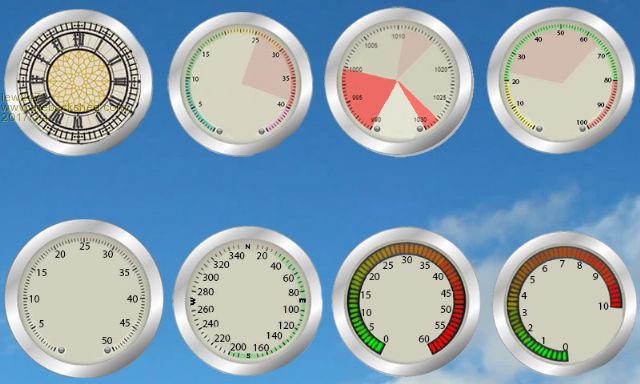

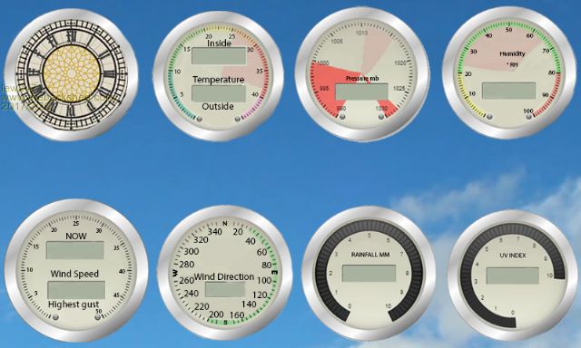

Hi Lewis,
Thanks for the boards. I have done a little bit of work to earn them. Its not complete but it should show you enough to see you are on the right track and its possible to have dials and readouts on you existing background. I have added code to generate demo movement for the dials, thermometers and rain gauge. This code should run and pull data from the ESP8266 on COM2 and it should show the gauges being exercised stepping from min to max value.
It is all based on Peters gauge demo from here.
Photo realisting Gauges
I have just put a couple of wrappers around it and duplicated for two sets of gauges.
This is a snap of the code generated dials etc.
The code
2017-01-09_120337_BigBenClock_WeatherGA.zip
Gerry
Code if anyone wants to browse without downloading the zip.

Sub dial(grp as INTEGER,dn as integer,mode as integer,value As float, size As integer, x As integer, y As integer,amin as float,amax as float,vmin as float,vmax as float,units as string)'Sub to draw dial needle
Local integer x1,y1,x2,y2,x0,y0,i,s,t
Local float angle=value*0.36
if value<vmin then value=vmin
if value>vmax then value=vmax
angle=amin+((amax-amin)/(vmax-vmin))*(value-vmin)
if units<>"" Then
if mode=0 then text x,y+10,units,CT,1,2,RGB(BLACK),RGB(63,133,195)
s=len(str$(vmax)):t=len(str$(vmax))
if t>s then s=t
text x,y+45,str$(value,s,0),CT,1,2,RGB(BLACK),RGB(white)
end if
'prepare the new triangle and save the old one
rotatetriangle(grp,dn,RGB(BLACK),angle,x,y,-size/15,0,size/15,0,0,-size*0.9)
'draw the centre of the dial
Circle x,y, size\8, 0, , RGB(BLACK), RGB(BLACK))
'Circle x,y, size\15, 0, , 0, 0
'Circle x,y, size\20, 0, , RGB(gray), RGB(gray)
'********************Sub to draw clock hands. i.e 3 dials **************************
Sub hands(grp as INTEGER,dn as integer,seconds As integer, minutes As integer, hours As integer, size As integer, x As integer, y As integer)'Sub to draw hands of clock
Local float angle=seconds*6
rotatetriangle(grp,dn+2,RGB(RED),angle,x,y,-3,50,3,50,-3,-size) 'make up the second hand with two triangles
rotatetriangle(grp ,dn+3,RGB(RED),angle,x,y,3,-size,3,50,-3,-size*0.9)
angle=minutes*6 + seconds/10
rotatetriangle(grp ,dn,RGB(BLACK),angle,x,y,-size/15,0,size/15,0,0,-size*0.9)
angle=hours*30 + minutes/2
rotatetriangle(grp ,dn+1,RGB(BLACK),angle,x,y,-size/12,0,size/12,0,0,-size*0.7)
Circle x,y, size\12, 0, , RGB(red), RGB(red))
'********************Sub to draw Rain Guage **************************
'Consists of two triangle.
'The height increases proportional to the area(volume) held in the guage.
'The slope of the guage is 1 in 5. e.g width is 1/5 of height.
'Area=height*width=height*(height/5)
'Height is SQR(10*Area)
Sub bar_RainGuage(grp as INTEGER,dn as integer,mode as integer,value As float, size As integer, x As integer, y As integer,vmin as float,vmax as float,units as string,dsize as integer)'Sub to column
Local integer x1,y1,x2,y2,x0,y0,i,width,height,temp
Local float angle=0,scale 'horizontal
scale=size/SQR(10*(vmax-vmin))
height=sqr(value*10)*scale
width=height/5
if units<>"" Then
if mode=0 then text x+90,y+2,units,LT,1,2,RGB(BLACK),RGB(WHITE)
end if
IF dsize>0 then
's=len(str$(vmax)):t=len(str$(vmax))
'if t>s then s=t
text x+90,y+2,str$(value,dsize,0),RT,1,2,RGB(BLACK),RGB(white)
end if
rotatetriangle(grp,dn,RGB(RED),angle,x,y,0,0,0,-2,height,0) 'make up guage with two triangles
rotatetriangle(grp,dn+1,RGB(RED),angle,x,y,height,-width,0,-2,height,0)
Sub bar_Thermometer(grp as INTEGER,dn as integer,mode as integer,value As float, size As integer, x As integer, y As integer,vmin as float,vmax as float,units as string,dsize as integer)'Sub to column
Local integer x1,y1,x2,y2,x0,y0,i,height
height=size*(value-vmin)/(vmax-vmin)
' angle=amin+((amax-amin)/(vmax-vmin))*(value-vmin)
if units<>"" Then
if mode=0 then text x,y+45,units,CT,1,2,RGB(BLACK),RGB(WHITE)
end if
IF dsize>0 then
'if t>s then s=t
text x,y+45,str$(value,dsize,0),CT,1,2,RGB(BLACK),RGB(white)
end if
rotatetriangle(grp,dn,RGB(RED),angle,x,y,-3,5,3,5,-3,-height) 'make up guage with two triangles
rotatetriangle(grp,dn+1,RGB(RED),angle,x,y,3,-height,3,5,-3,-height)
'********************Sub to draw parallel guage dial **************************
Sub bar(grp as INTEGER,dn as integer,angle As float, size As integer, x As integer, y As integer)'Sub to column
'Local float angle=value*0.36
rotatetriangle(grp,dn,RGB(RED),angle,x,y,-3,5,3,5,-3,-size) 'make up column with two triangles
rotatetriangle(grp,dn+1,RGB(RED),angle,x,y,3,-size,3,5,-3,-size)
'angle=minutes*6 + seconds/10
'rotatetriangle(dn,RGB(BLACK),angle,x,y,-size/15,0,size/15,0,0,-size*0.9)
'angle=hours*30 + minutes/2
'rotatetriangle(1,RGB(BLACK),angle,x,y,-size/12,0,size/12,0,0,-size*0.7)
'Circle x,y, 5, 0, , RGB(red), RGB(red))
'Circle x,y, 4, 0, , 0, 0

'******************************PAGE 1 Draw Left 200 Pixels of screen**************************************
SUB Page1
DisplayPicture "3.ppm",200,0 'Background Image
Text 610 ,15, Str$(temp), CM, 1, 2, RGB(BLACK), RGB(48, 107, 167) 'Display the Indoor Temperature
Text 660 ,15, "`C" , CM, 1, 2, RGB(BLACK), RGB(48, 107, 167) 'Display the C symbol
Switch1
'Initialise dialset 1
dial(1,0,0,d4,82,320,124,-135,135,0,50,"MPH") 'speed
dial(1,1,0,d5,82,518,125,-155,155,500,2000,"mb") 'pressure
dial(1,2,0,d6,82,320,378,-135,135,0,50,"MPH") 'av speed
dial(1,3,0,d7,82,511,383,-135,135,0,100,"Percent") 'humidity
dial(1,4,0,d8,82,696,380,-180,180,0,360) 'direction
bar_Thermometer(1,5,0,d9,145,646,185,-10,50,"",3)
bar_Thermometer(1,7,0,d9,145,727,185,-10,50,"",3)
'read current background into the secondhalf of the buffer b
i=triangles(ntb, buffb() , tcolb(ntb), xx0b(ntb), yy0b(ntb), xx1b(ntb), yy1b(ntb), xx2b(ntb), yy2b(ntb))
Print "Read buffer is ",i/buffersizeb*100,"% used"
ChangePage=0 'ok to go on now
END SUB

I wasn't happy with the background picture and the other half kept moaning at me that the "Big Ben" clock looked totally out of place.
I've redone the background picture as just 1 .ppm file now to be loaded at startup
With the new BLIT command this "should" work well
Although I haven't started on the new software yet you can see where I'm going
My plan is have the main display showing the relevant information with a "largish" weather icon showing somewhere on the bottom left with some other bits
The CURRENT day will show inbetween the 2 sets of dials - in a nice font!
Touch the display anywhere on the screen and the "DAY" changes to "tomorrow" or whatever day tomorrow is and the dial sets will show the PREDICTED information from the internet
Touch the screen again and it shows the next day and so on for probably 3 or 4 days in the future
Touch it again and it shows todays weather
That's my idea.... UNLESS any of you have any better ideas?

The pictures above were taken from my computer not the Micromite display
I wish there was a way to have transparent picture backgrounds, the picture above actually shows the cloud as a .PNG file which lets the transparent background show
But it still looks ok with a white background - BUT the picture has to be shrunk to fit... or the backround covers the dials
New pictures enclosed in case anyone wants to try them

Updated pics to use as the background
removed the writing and text box as they can be done in software
The bottom right is UV index and the one to the left is rainfall in mm

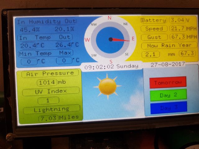

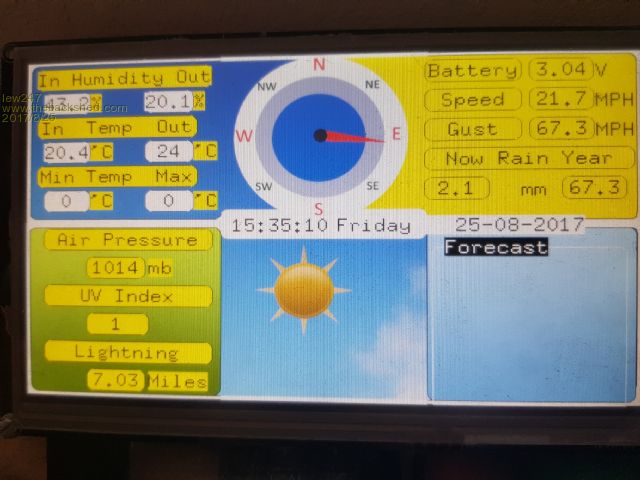

I've finally got round to doing more work on it to "try" and make it look a bit better
Can you let me know your opinions, and opinions on how to make the display look better please
It's not exceptionally "pretty" and it's definitely not finished
I'm open to any ideas (and/or help)
As you might notice I've included Lightning detector results although I haven't started on the code for that yet (or the hardware)
I want the bottom right to be a set of touch buttons that say something along the lines of
"Tomorrow"
Day 2
Day 3
Day 4
the buttons would obviously touch sensitive and able to pull the readings from com2 and display them where needed
I'd also like to include an UP and Down arrow that lights up to the left and right of the Pressure reading to indicate if the pressure is rising or lowering - not figured out how to do that yet (might use an led but an arrow would look better)
The weather icon is too high I know that and it's going to be repositioned lower on the display I just haven't done that yet
There is one thing that's bugging me - the day of the week does not change once the program is run, yet the time and date do
Code attached in case anyone wants to look/suggest changes
2017-08-25_153439_weather2-test.zip Edited by lew247 2017-08-26

Does this look better than the picture above?
