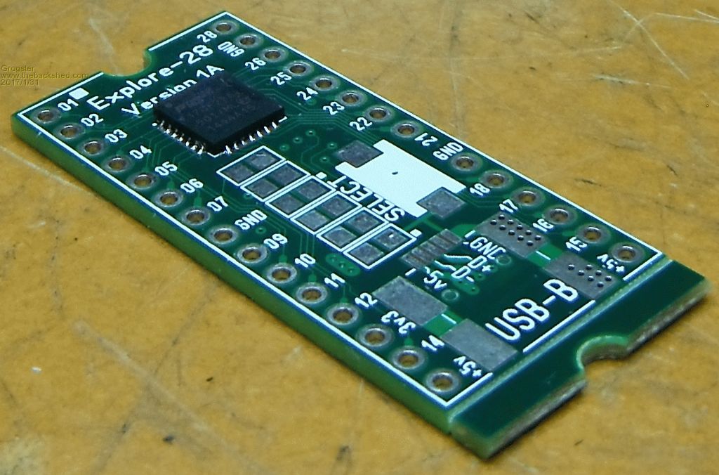

Did you hand solder the QFN shown in the bottom picture?
WW
Posted: 11:10pm 29 Jan 2017
  WhiteWizzard said   Neat job there Rob.
WW
yep, all soldered by hand. the QFN package was 'glued' in place using a tiny drop of nail varnish. next SP-44 rosin based flux was packed around the edges, before soldering using the bit shown in the first photo (by dragging the bit across the pins/pads).
the bit is a weller PTK-6 (600 degrees F, 315 degrees C). the rest of the assembly was done with a standard PTA-7 bit (700 degrees F, 370 degrees C). leaded solder was used throughout.
the QFN package was actually the easiest part of the assembly, while the USB socket was the most tricky.
rob :-)

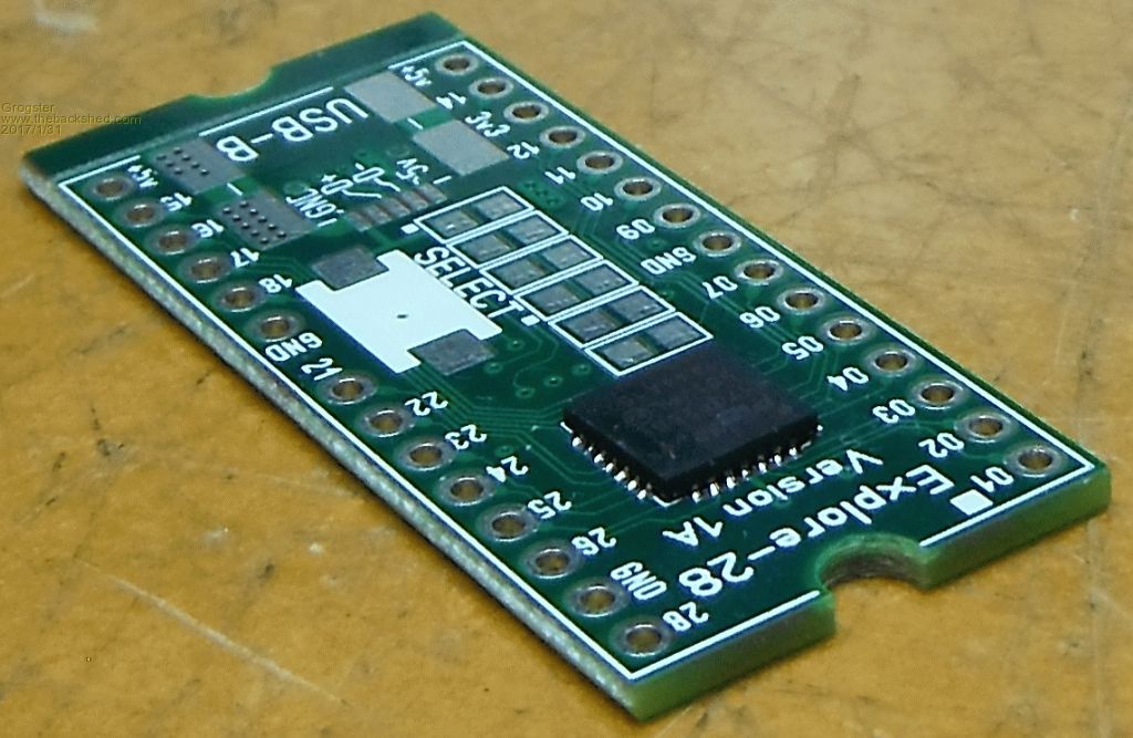

Well, here is my attempt:
This is the very first QFN I have done, so I will probably get neater as I do more of them. Difficultly level: 5/10.
Not really a problem, in other words. This was hand-soldered with a bench iron, same as Rob did his one.
In my case, I used a TINY bit of blu-tack under the chip, to both hold it there while soldering, and make it nice and easy to move the chip around for alignment. You press the blu-tack flat with your finger, then press the chip onto that. This means the blu-tack will hold the chip SLIGHTLY proud of the PCB, but that is probably not a bad thing, as the solder can then flow under the pads to form a nice solid connection. The blu-tack holds the chip there while I mount the PCB at 90-degrees so I can see the pads and the lands on the chip. Apply flux-gel, and soldering was easy. Does require about one second longer per "Pin" then the standard QFP chips, but once it is on the move(the solder), then it flows very painlessly to where you expect and want it to sit, so overall, very pleased with how easy they are to solder, when I thought they would be a right pig.
I'll try to build the rest of this module tonight depending on time. Rob having got his one finished has prodded me to get a move on!
