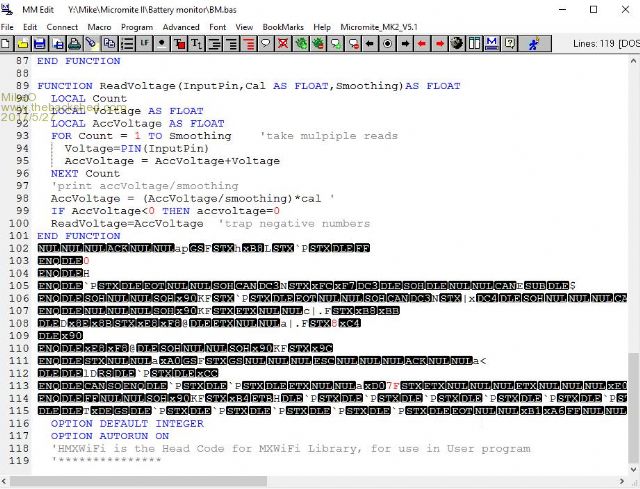

Hi Jim , I had loaded the latest MMEdit from your web site 3.7 I think but it has given me grief a couple of occasions so i had to go back to previous version. It happens when i save the document,it seems to copy part of the program again plus a load of control char, sorry its not a very clear screen shot.

I can't look at it for a couple of weeks but what version of Windows are you running?
Showing control codes for part of the edit window is strange and not an area I have much control over. I suspect it could be the DLL that does those fancy bits.
I will experiment when I get home.

Hi Jim, I should have said of course. I am using windows 10 on two machines and have seen the problem on both. I wonder how many others may have seen it if they have updated or perhaps its just a windows10 combination issue.

  MikeO said   Hi Jim, I should have said of course. I am using windows 10 on two machines and have seen the problem on both. I wonder how many others may have seen it if they have updated or perhaps its just a windows10 combination issue.
Cheers Mike
W10 here also.
Is it when you save to disk or when you send to the mite?
The control codes look a bit like XMODEM flags.
Can you PM me a copy of one of the corrupted files.
Also a copy of your configuration report.

Hi Jim, OK I will have to set up with the new version again and see if i can create a bad file. Its when I save and save a crunched file, then transfer by using the Teraterm macro, I never use the built in transfer.

Jim, I reloaded 3.7 yesterday and gave it quite an extensive test while rewriting some code and all went without a hitch, no problems as previously experienced so sorry for report raised. Perhaps it was just something in that particular file at the time causing the problem ? just don't know.

Glad it's working for you although it would have been nice if the error could be repeated. Much easier to fix if you can see it!
I did some testing using your BM.BAS file posted elsewhere but couldn't fault it either.
I did find an unrelated bug so the time was not wasted.

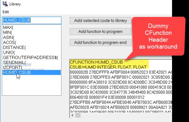

A small one if you are doing any update in future.
The library does not index CSUBs that it contains. I think they add in OK, just not listed. My workaround is a dummy CFUNCTION header.
Its handy to have HUMID etc now they are CSUBs.
Gerry

I will have a look at it but it will be a few weeks before I can put out any opdates.

I can fix the missing CSUB from the library.
