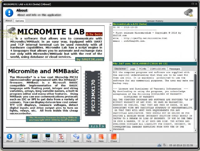

Micromite Lab is ready (0.92 beta), if anyone wants to try it out, it's enough to contacts me on info@sagt3k.com. I will send you a zip file of about 6MB that will contain the .exe and .dat files. After the first start the SW autoconfigure and create a third file .usr(where will reside your programming codes and parameters). The software is completely free, portable and runs on all Windows systems. The COM is automatically recognized.
For now, the manuals are not present, but if you give me a hand I can rapidly conclude them. To give an example about it is interactive, just connect any Micromite go to the third page, and then press RUN. Then you can go to CODE for write code or CONSOLE to connect to the COMx / TCP ports etc.

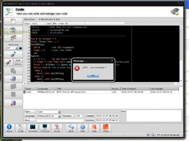

I'm trying the code on W10 64-bit. I can connect with the console and the break and run buttons work fine. However, the load program button give the message "uCPU not connected", same for the read code from uCPU button
sagt3k
Joined: 01/02/2015
Location: Italy
Posts: 313
Posted: 09:11pm 06 Oct 2016
Hi Matherp
It is necessary that you are not in "micromite edit mode". The SW search the prompt ">" why I need to start with "autosave" command in upcode and "list all" in download code.
Posted: 09:32pm 06 Oct 2016
The Micromite is in normal console mode. I go to the console type return and I get ">". I then go to the code window and click "write code to uCPU" and get the error

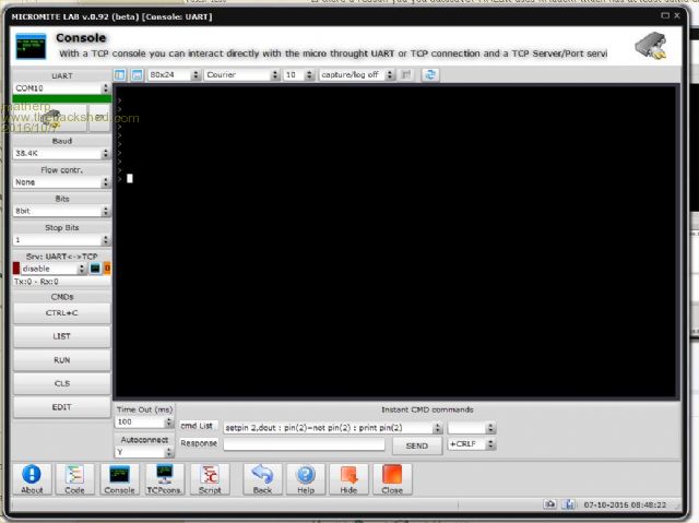

In the "CONSOLE" you can find "TimeOuT in ms". You can try to increase or decrease the value. Can you to do a schreenshot where I can see the console? So I can see the problem.
Posted: 09:46pm 06 Oct 2016
As before timeout now 100msec (huge!!!)
Connection works perfectly from the console window.
Is there a reason you you autosave? MMEDit uses XModem which has at least some error checking

Console form ...thanks

This is very strange.
Please can you describe me, if you use usb/uart, which micromite etc?

  matherp said   Hi
Exactly the same for me on win10 64bit
