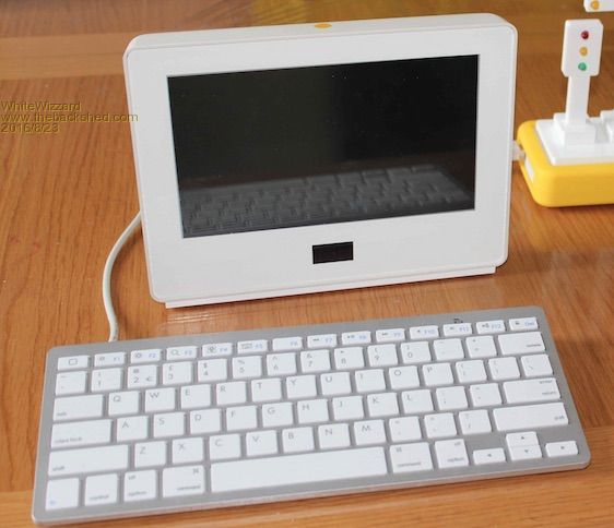

My point about keyboards was that a normal size keyboard just seems wrong with a "small computer".
I have several raspberry pi with 7" screens and the normal size keyboard seems out of proportion and in my mind the system needs a mini keyboard, the same with the explore 100 and a 5" screen. Perhaps I'm just weird.
Again thnaks for the help and for supplying the board.
Posted: 11:47am 23 Aug 2016
Oh - yes I see now what you mean
If you are familiar with the iMac wireless (BlueTooth) keyboard - I modify a BT keyboard identical to this (dare I say it, they are cheap on eBay) and convert it to PS2. End result is a stylish and small keyboard that is proportioned beautifully
I will see if I can find a photo . . . .
Posted: 11:53am 23 Aug 2016
Here is a 'modified' keyboard that works well with the MM+
It does not have a Home or End button so Geoff kindly made Ctrl and cursor keys mimic these functions in the early days of Beta Testing.
Note that in this photo the MM is connected to an 8" TFT. However, it looks good with a 7" and a 5" too.
