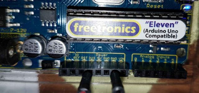

I'd overlooked pulling GPIO0 low, but I've also taken3.3v power from an Ardruino board now as well.

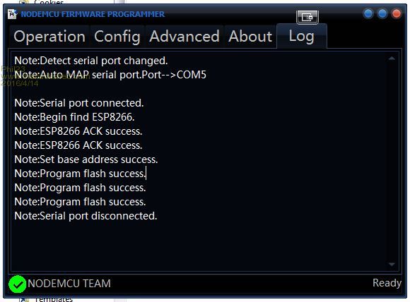

The programmer returned this in it's log:-
But on reset I don't seem to see an available network.
The AI-Thinker AP is no longer visible.

  Quote  although I've also taken power from an Ardruino board now as well
3.3V from an Arduino?

Log from the programmer seems ok?

no, it is not a valid supply, in the sense that it is produced by the arduino's USB to serial bridge chip. a maximum of only 50mA or so can be drawn.
might i suggest a 3x AA battery holder - one of the nice ones available on ebay with a built-in switch:
http://www.ebay.com/itm/381208208080
along with a 3-terminal LDO regulator like the LM1117-3v3 in TO-220 package:
http://www.ebay.com/itm/221897784452
assemble LDO regulator on a piece of veroboard, along with filtering capacitors (0.1uF ceramic + 10uF electro on input terminal, 0.1uF ceramic and 100uF electro on output terminal), and a high-brightness LED + series resistor across the 3v3 output to show that the battery is switched on. high-brightness LEDs will usually give a fairly bright indication with 1mA or less of current, so won't excessively drain your batteries.
this will give you a good solid 3v3 supply, is isolated with no 50/60Hz hum, and should provide you with enough juice for at least 10 or so hours while you get things set up.

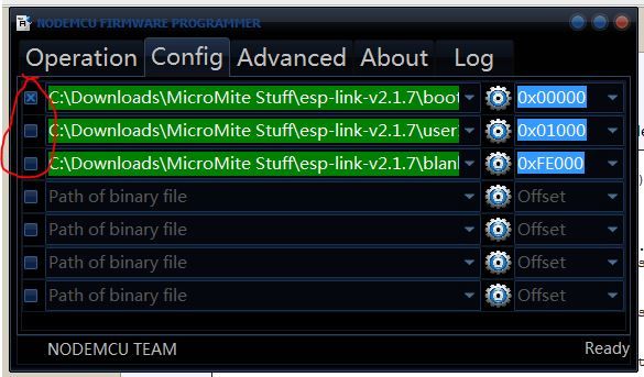

Problem finally solved!
Programmed & up & running.
Most of my issues were related to inexperience in this general area, along with a few slip ups.
Thought I'd list them for others who fall off the pearch.
[Code]
1. Hold CH_PD high, (Got that one from the start).
2. Pull GPIO0 low, (One I missed initially).
3. Be aware of how good your 3.3 power supply is.
(In hind sight both CP2102, & the one from the Ardruino board worked,
but as others recommend, something more beefy would be better).
4. Know you flash size, I didn't, and had to make an assisted guess.
5. Basic Flash would not load unless reset pin is momentarily pulled low
after the flashing process is started.
6. After EspFlasher is told to flash, also pull the reset low momentarily.
7. And finally, check that all the binaries are selected to be loaded.
This was my final brick wall.
Initially they were all checked, but at some point the 2nd & 3rd became
unchecked & it was something I was overlooking, leading to all the hair tearing.
[/code]
Thanks to all who have helped.
Cheers.

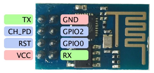

Using the picture below could anyone please confirm which pins go where when flashing the ESP8266?
Also what is the program (ESP8266Flasher.exe) meant to say while flashing, and how long does it take?
Do the tx pins go to rx on the flasher and vice versa?
Finally could someone please confirm which pins go to the console pins on the Micromite?

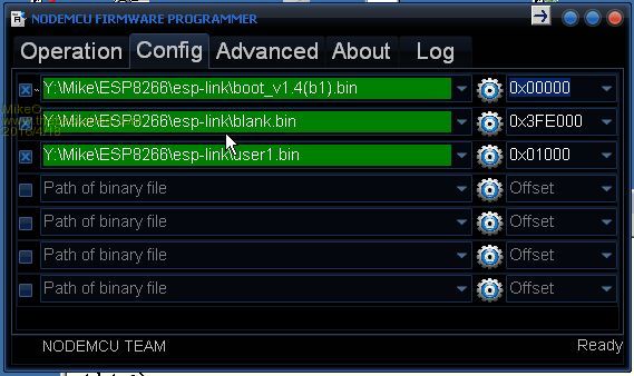

You can use this diagram.
You don't need the serial resistors.
This is my setup, you have to have X set on the left hand side or it won't flash the files. See this link, scroll down to "Install via serial upload".
This should always work ,you don't need to set the baud rate, if it doesn't start and you have boot set then you have the TX/RX lines the wrong way round.
Good luck Mike.

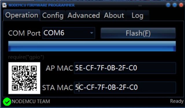

I'm pretty sure it flashed correctly
but
I can't find it - there is no wifi network detected by my laptop or phone
I was hoping to see this [code]esp-link creates a wifi access point with an SSID of the form ESP_012ABC (some modules use a different SSID form, such as ai-thinker-012ABC)[/code]
no network other than my normal wireless router
any ideas?
This is what came up after flashing so I'm assuming it went right
