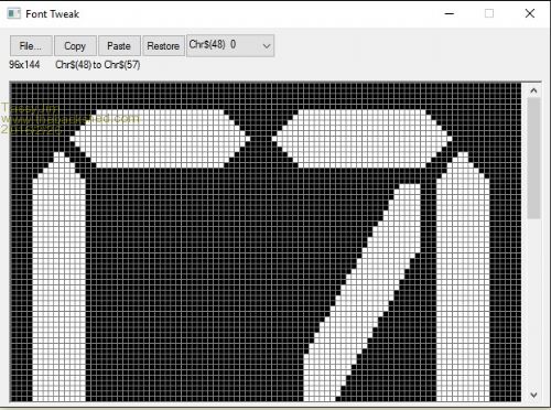

Posted: 07:43pm 25 Feb 2016
Scrollable area to allow for Phil's grand designs.
Also:
The 'insert' key adds a new character to the end of the set.
'delete' deletes the last character in the set - NOTE not the current displayed character. I will change that to only delete it if it IS the current character.
NEW now starts a blank set ready for 'insert'ing characters.
'insert' and 'delete' work on existing sets, not just new ones.
Please keep trying to destroy it. I don't have a TFT display setup to test the fonts on at the moment.
2016-02-26_054113_FontTweak.zip

As a quick workaround until its another rainy day in Tassie, just tweak the header to say more characters exist before you open with Jim's program and then you have the extra ones available. You just need to touch each new one with something before you save if you don't want to use all the new ones straight away so it saves with data. I just added 16 new ones to my hand coded font this way.

The 'insert' key now adds another character at the end of the set.

This update uses ctrl-X to delete the last character in the set and ctrl-N to add a new character to the end of the set.
Insert and delete still work for those of us with proper keyboards.
There is one other change. If you try to delete a character and you don't currently have the last character active, it is NOT deleted but the last character becomes the active one.
If you still accidentally delete a character, try inserting a new character. You might find that the old character has returned.
2016-02-28_042916_FontTweak.zip

Been playing with your latest (Ctrl-X, Ctrl-N) version and it's looking good.
Have managed to uncover a few things so here's my feedback:
1> With 'New', if you input 'garbage' for the character size (X x Y) it creates a blank edit window (i.e. zero pixels). To avoid this, can I suggest you force the input of the X and Y values separately. This would allow very easy error checking for you (and only allow for numerics). Also when entering the X value; highlight that the entered value will be rounded up to the nearest 8.
2> When the new file is created, it starts at the character value you inputted during the 'New' option. When you create a character and then press 'Save', it does not save it (this took me a while to work out why). The 'artwork' is only save once you select another character (which there isn't) so I had to Insert another (blank) Character first, which then saved my 'artwork' for the first (and the only required) character. Can I suggest that 'Save' automatically saves the current artwork into the on-screen character number
3>When I used New, and selected start at a number below 32, I then shut down your app, and then opened it again using OPEN, selecting the font just created. However, you app came in at Chr$(32) but I had selected a character lower than Chr$(32) and hence just had an 'empty' edit window
Everything else seems to be working really well.
I am currently using the app to create a 128x128 Logo bitmap (as a single character font), and then displaying the required Logo very quickly with the TEXT command.
Going to try 'animate' the logo next
Will report back anything else I find . . . .
Great work Jim

Posted: 10:49am 28 Feb 2016
The information at 'rinkydink' definitely requires multiples of 8 for the horizontal bits. There is no restriction on height.
I don't know about MMBasic requirements but I expect that you can't split bytes across characters and possibly across rows.
Padding may be required.
As far as WW's other points, I have a few things to fix.
Posted: 11:43pm 28 Feb 2016
Today's update fixes a few of WW's last list.
Not sure about item 3. I was unable to reproduce it so I might not have fixed it.
I have added two new functions.
ctrl-W will convert the loaded font into 'Wide' characters. double the width and the same height.
crtl-2 will convert the loaded font into double width and double height.
In both cases there is no attempt to smooth the results.
I will eventually make a proper panel for entering the NEW font details and proper menus.
2016-02-29_094156_FontTweak.zip
As usual with this project, I have not done much testing...
