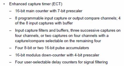

Timer input capture is ideal, because you can program that to work on either edge.
But you are going to need three input capture channels for three phase.
And if you also have three output compare channels, its then dead easy to set up any delay with maybe 1uS resolution, and make the delay the same on all three channels.
Then you are going to need at least one analog input for voltage feedback, and perhaps a second analog input for current limit.
Something like a Motorola 68HC11 or 68HC12 has all that.Edited by Warpspeed 2018-05-26

Agreed.. I would also like a "six pack" of them for the 6 pulse system needed... And it would all be done with hardware and interrupts... If they are 16 bit timers, I think the output voltage could be controlled nicely..
I would also need missing phase detection and rotation correction so that any combination of wiring errors wouldn't cause problems...
I wonder if there as a "basic" firmware core for the 6812 MPU..?? I sure would miss Geoff's working environment..!!
EDIT: Looking at the data sheet... Nice...
With 10 bit A/D's for sensing, this could just do the trick..!
And, I think I found a "Basic" compiler for it... More head scratching needed...

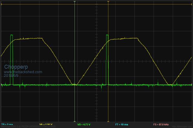

My requirements are simply for a trigger pulse for an SCR generated between ~ 1mS & 10mS after a 10mS trigger interrupt. The pulse delay needs to be proportional to an input voltage from 0 to ~3V.
The photo shows a short pulse being generated triggered after about 3.5mS from the zero point in the rectified AC wave. (We have flat topped Mains here in Aussie land). The pulse was generated using several PULSE commands which is not ideal.
Zonker wants to control 3 phase which probably means 3 pulses every ~8.3mS (60Hz), each shifted 120 deg in phase.
Hope this clarifies things a bit. Thanks for any help you are able to offer.
