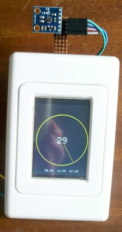

Speaking of which, this program draws a compass needle and gives bearing an the 3 components.
It requires a ILI9341 in portrait mode.
The HMC5883L is oriented with the x axis pointing 'ahead' or 'up' and the y axis to the left.

Posted: 01:40pm 09 Mar 2016
Jim,
Many thanks for posting this - something else of great interest to add to the to-do list!
You mention that it requires an ILI in portrait mode. Purely out of interest, is there a reason why it won't work in landscape mode? I've only quickly run my eyes over the code and nothing obvious stands out.
This could look really good on one of those round TFTs
Thanks again . . .
Posted: 02:15pm 09 Mar 2016
No big problems with landscape mode.
The display of the 3 vectors may need to be relocated. With the current code, it is below the compass circle.
In landscape, it will be over part of the circle.
Posted: 05:36pm 09 Mar 2016
The sensor is mounted up front to be away from big hands.
Red points to magnetic north and the current bearing is in the centre.
The 3 numbers at the bottom are the three x, y and z vectors in uT
It is fun playing with a reed switch magnet in close proximity.
You can also point the 'compass' up (down in the northern hemisphere) to maximise the x reading and minimise the other two. This gives you the angle that the magnetic field is coming down at - about 70 degrees where I am.
At the maximum, I read about 56uT which compares reasonable well with the expected 61uT.
I will try it outside away from local interference sometime.
Compass combined with accelerometer is next on the list.

palcal
Joined: 12/10/2011
Posts: 2053
Posted: 08:32pm 09 Mar 2016
Hi Jim,
Thanks for posting the code all seems to work except when I move to compass through 90 deg. to point East it reads 135 Deg then South is 230 and west is 295 and then back to North Zero deg. I made the changes you mentioned. Is yours reading in a linear (or should that be circular) fashion.
Paul.
Edit BTW where did you get the case, by far the hardest part of a project.Edited by palcal 2016-03-11
Posted: 08:38pm 09 Mar 2016

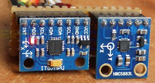

I think your sensor might be upside down compared to mine.
When you rotate, does the red end of the compass needle stay pointing north?
After some reading, I have decided that there is no need to scale the Z axis any different to the X and Y axis's.
I will update the program with a different set of gain figures.
I should be able to allow for the sensor being up the other way while I am at it.
palcal
Joined: 12/10/2011
Posts: 2053
Posted: 08:47pm 09 Mar 2016
I have mine with the chip facing up.
I also meant to ask why an accelerometer with a compass.
Paul
Posted: 08:53pm 09 Mar 2016
I re-read your post.
If I keep the sensor in the same location, it behaves correctly but if I hold the display in the same location and therefore move the sensor around in a circle, I get strange results. This is because I am too close to mag fields. A long power lead and standing in the clear will work better.
Keeping it level makes a difference too.
The 'case' is a blank electrical power outlet.
I don't have the luxury of a CNC miller but the Dremmel and a shaky hand does a reasonable job of cutting the opening.

Posted: 08:57pm 09 Mar 2016
Paul
An accelerometer gets your tilt/inclination. Together you can calculated the mag field in 3D.
We 'should' be able to end up with a compass that works on any angle.
palcal
Joined: 12/10/2011
Posts: 2053
Posted: 10:10pm 09 Mar 2016
I had my compass outside well away from any interference when it was reading incorrectly. I also had it flat on a table so it was not at an angle.
Paul.
Posted: 11:41pm 09 Mar 2016
  Quote  I found a bug in the scaling factors for the Z axis when the gain is 4.7
Line 48 to 50 should be
CASE HMC5883_MAGGAIN_4_7
hmc5883_Gauss_LSB_XY = 400
hmc5883_Gauss_LSB_Z = 355
the Z axis was 255 - should be 355.
Also change it in the CASE ELSE section.
This gives a better maximum value for the Z axis.
Where are you getting these numbers from? The datasheet I'm looking at seems to say the scale is 390 in both cases
palcal
Joined: 12/10/2011
Posts: 2053
Posted: 10:14am 10 Mar 2016
With the latest code North is showing at about 40 Deg. When I rotate, the red line also moves by about 40 Deg.
Paul.
Posted: 10:47am 10 Mar 2016
I found some Arduino code from Adafruit. Most of the other code I found on the net seemed to use it as a base so I converted it.
My later code posted here uses the values from the data sheet with Z the same as X an Y.
I am still not sure where the Adafruit code got its figures from seeing they had the datasheet.
palcal
Joined: 12/10/2011
Posts: 2053
Posted: 06:30pm 10 Mar 2016
@Jim,
I also see that when pointing North the heading can read either 360 Deg or 0 Deg.
Should it not be one or the other.
Paul.
Posted: 07:21pm 10 Mar 2016
After:
heading = INT(DEG(Atn2(yh,xh))+.5)
add a line:
if heading = 360 then heading = 0
I have been trying to add compensation for tilt but not very happy with the results.
Two application notes from Honeywell give conflicting information.
I am using a MPU6050 to get the tilt OK but the formulas for correcting the X and Y mag readings don't seem to give me acceptable answers.
I think I will have to give it a rest and work on something else for a while.
Posted: 10:34pm 10 Mar 2016
Attached is a full AHRS implementation using MPU6050 and HMC5883 you may recognise some of your code in there
The issue I'm not sure of is the relative relationship of the x, y and z axis of the two sensors in the call to the sensor fusion routine
MahonyAHRSupdateMag(gx, gy, gz, ax,ay, az, -my, mx, -mz)
I'm using x=-y, y=x, z=-z and it seems OKish. I've also got a version for the MPU9250 but bizarrely this chip is also a composite of two dies with the magnetometer separate and the axis aren't aligned in it either
